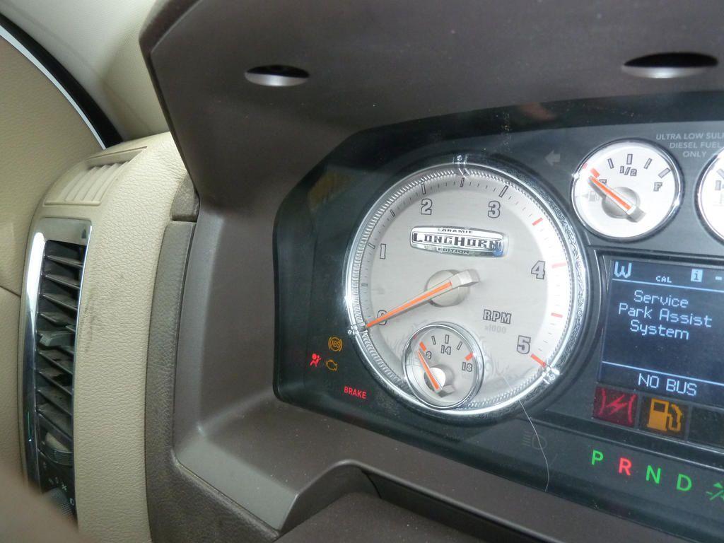

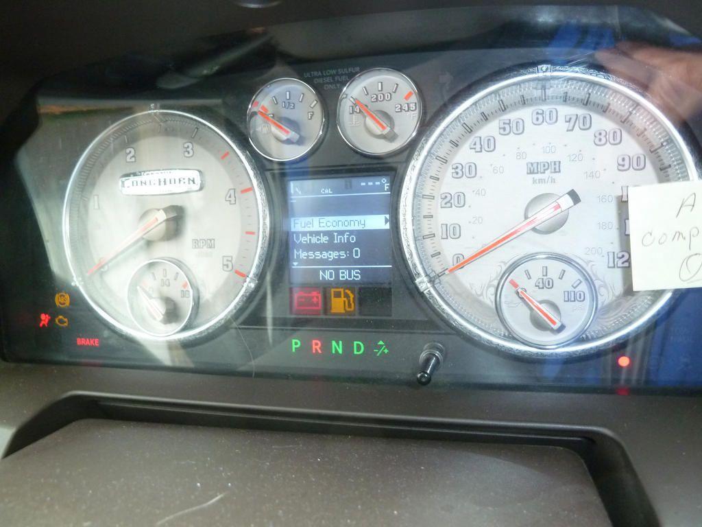

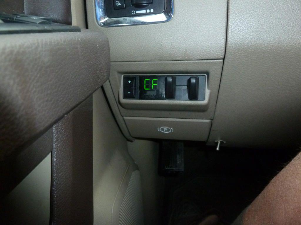

This is for my Dad's 2012 LongHorn 2wd Dually 68rfe. His wipers will not shut off. The pics below show other issues. He did disconnect the battery cables but that changed nothing. Thanks!

He has a bus communication problem. When that happens the controllers are set to turn on the lights and wipers as a default because the truck does not know if it is dark or raining. It is a safety thing so it can still be driven. It is most likely the interior bus if the truck starts and runs. Was anything done in the last few days or weeks to any wiring? Most often it is a bus wire shorted or a bus wire pushed out of a connector. The voltage needs to be monitored on the bus to get a better idea of what is happening.
It runs fine. What is a "interior bus" ? Nothing has been done.

Your truck has an interior low speed bus communication system for non critical modules and a high speed bus for critical modules like PCM, ABS, and air bags. Bus voltage will still need to be monitored to find the problem The good news will be if it stays broken for diagnosis. Intermittent bus problems can be a real pain to diagnose.
