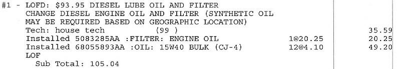

While at Bennett Dodge/RAM (Kingsland, GA) service department yesterday chatting with an ole’ Veteran. He is getting ready for his second retirement. They are using T4 (55gal drum) and the Mopar oil filter for 6.7L.
I recall my then local dealer in Iowa told me back in 2016 that the 4th Gen CTD Rotella T-6 was required to be used and Pennzoil Platinum in car engines or warranty was no void....
Service writer doesn’t know anything. First come first serve drop off in the am same day free first change. Their oil and filter . I can’t see them using synthetic oil or anything expensive.
They use the recommended oil and a Mopar Filter.

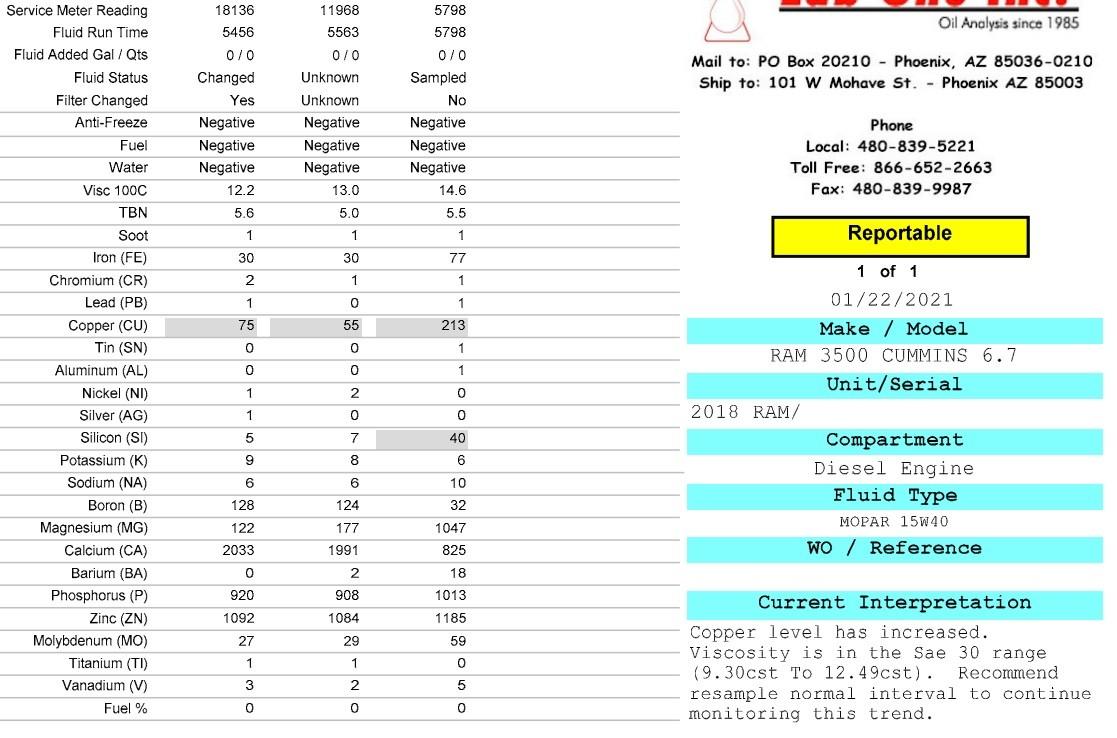

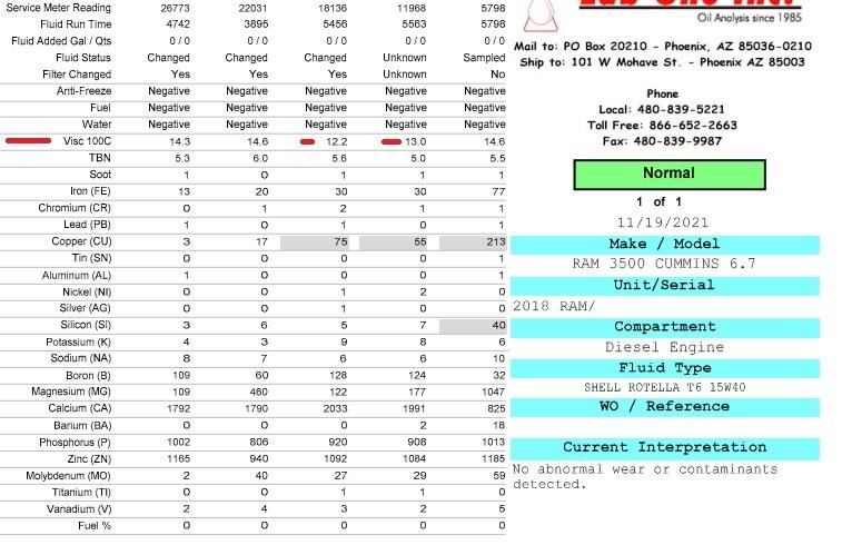

Trust but verify. The MOPAR oil filter is the standard Fleetguard paper filter with a different paint job. I would guess my dealer switched to all 2019+ oil grade to prevent 15W-40 getting into them like the 2018 on down calls for. Or the lube tech grabbed the wrong stuff... But Twice? o_O
Two dealer changes in red. Known oil after and nothing "special" shearing it down in the engine. Hmmmm.

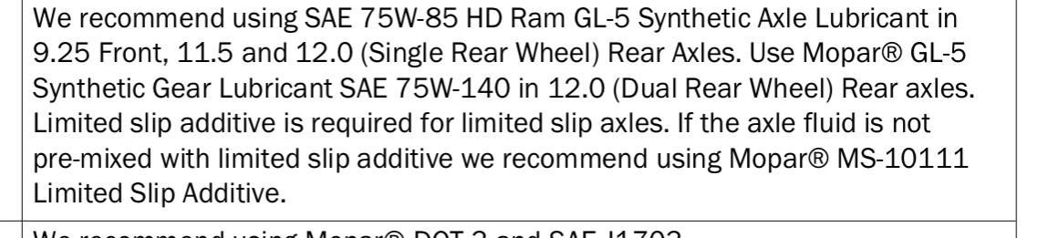

140 weight oil in the rear end? I thought the 90 is the recommended one.
It is (75w-85 actually, but I still run a 75w-90), unless it’s a HO DRW.
What funny is that we’re on the 4th model year with the 11.5 and 12.0 and the owners manual still doesn’t address what fluid to put in the 11.5” DRW axle. o_O
