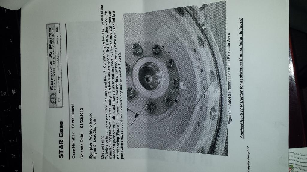

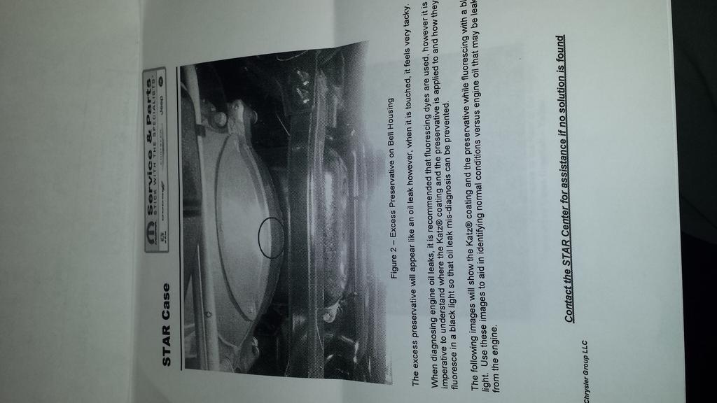

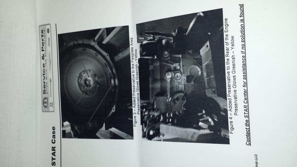

I know it's an older thread, but I wanted to try and post a pic or two. New guy here. Trying to upload pic of rear main seal leak bulletin. I thought I had the same leak on my 13 CTD and the service department gave me this. Hope it works. Turns out it was as Brockman said...assembly lube.
