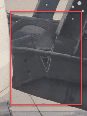

You can clearly see where the frame broke at the weld in that video.

Looks also like where the rear frame section is joined to the front frame sections, (I'll have to look on mine later where the lap joint is relative to the front mount but I think mine is farther forward). Either way, in Ram's defense, a pallet of shingles is 1~1.5 Tons.. so two of them could be 6000Lbs on the rear axle and that FB is longer than the std 8' bed that would've been std on a 3500. Im not saying its right or it should've broke, but there seems to be a common thread here of overloading (or potential overloading) and abuse that may not have been part of the design requirements. All the cases I've seen so far seem to appear to be fatigue failure from cyclic reversed loading of the frame. FWIW I ran many AG related crews in farming areas and the general staff we hired did not care or consider how they used (or abused) equipment... I saw and learned more about how things could be broke (on trucks, tractors, etc) working with them than on any career since,
Good job on saving a still photo of the video. I couldn't figure out how. I saved yours to my desktop and zoomed in on it and it clearly has been broke for a while, about the top 25%. So, who knows what they have hauled in the past.

At least its and easy fix :D. All one need to fix it is to slide a big chunk of solid steel into the hollow frame ( if possible at least 24 inches on each side of the brake) then drill some bolt holes insert HD bolts and its as good as new :rolleyes:
Yeah.. considering the team, the industry, and the likelihood that truck has had a hard life who knows was kind of my thought. Clearly a chassis cab would be a better option for that use, but they'll write it off and slide that bed onto another one by the end of the week.
If you look closely at the video, there is no frame. Looks like the only thing holding the front and rear together was the bell housing.
