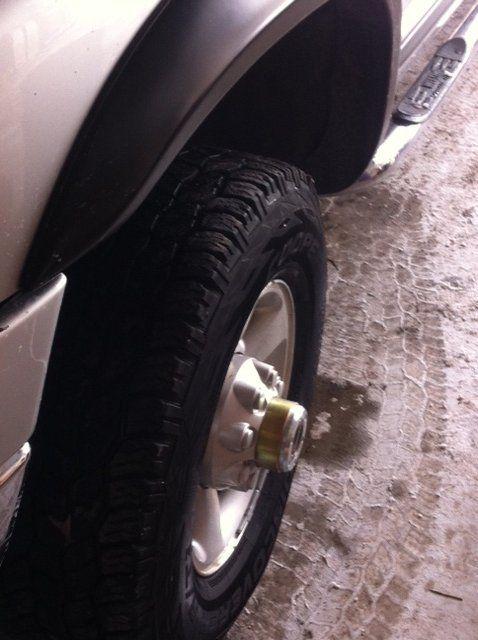

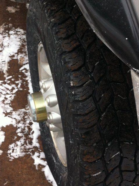

THe cutting of the bolts was required on the old units. The new design does not require cutting the bolts. It's a nice simple install now.
