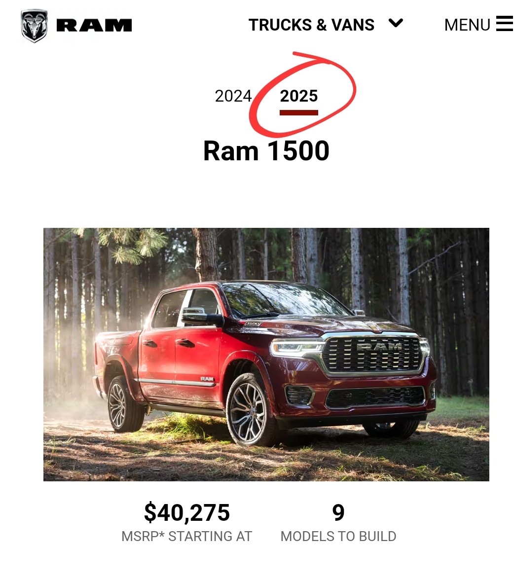

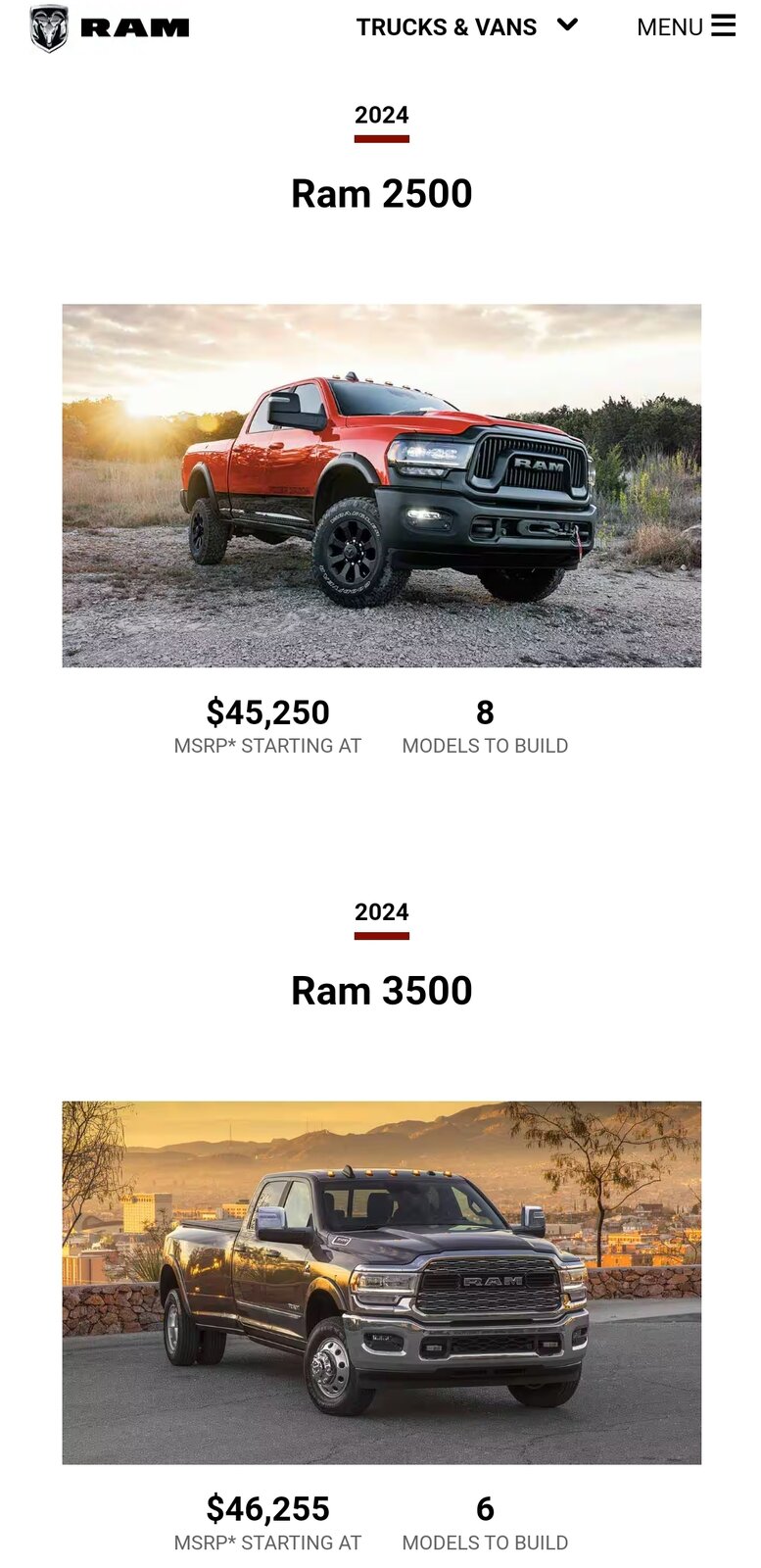

1500's have the '25 option.
The dealers should know the "expected" window for the '25, they are always behind is my opinion.
One idea is if it was the same it might be out already on the site.
