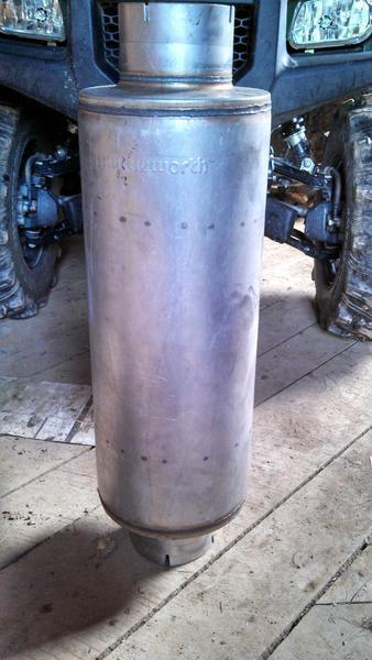

I've got a 5" Shuttleworth and love the tone. I have no resonator and have no drone while towing. It is a straight through type as well so no flow restrictions to worry about.
Wow! I thought my buddy and I were but a few using the Shuttleworth product. Paul Fox @ Orange Muffler spliced a Shuttleworth into my '07 5.9 over six yrs ago. Throatier sound with no drone. Mine is not the straight through one. Minimal corrosion after living 4 miles from the ocean too.
Most people have never heard of them but they are a very robust muffler. Built for MDT's and the like and built to last. I actually got mine off of a dump truck that had been totaled. The exhaust system was less than a year old so I cut it off and pieced it together with a new 5" turbo back system.

Wayne I'm honestly not sure what the Shuttleworths cost, I hacked mine out from underneath my cousins dump truck after someone ran an intersection and t boned him. In that link I posted above there is a link at the top of the page for a free quote, you might try that.
