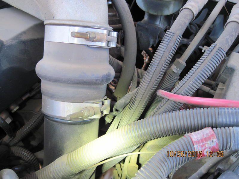

I have found the leak in the hose, but I am unsure what I need to order to make the replacement. Temporary, I have covered up the torn hose with silicon tape and reinforced with electrical tape. That has the air blowing out the vents correctly. Anyone know the exact part number I need to order? Hole is located just above the white spot of the flashlight.

If it the small hose I am seeing don't bother with Genos unless you are in the wilderness somewhere. Cut off a short piece and take it to your nearest auto parts store and buy enough hose to reolace all of it. If it goes into truck before you see a connection, buy a splice for that size hose and terminate the new hase as near the cab as you can. bg
