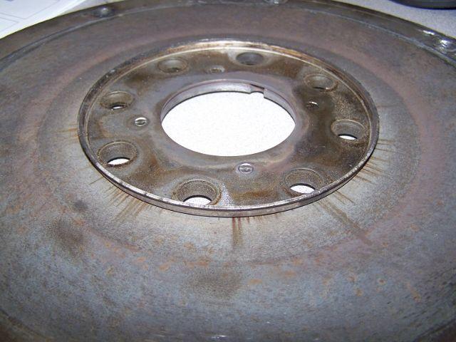

If you have not seen this part before, it is about 4" in diameter, and the flywheel bolts go through the eight holes. It pilots on the crank, and the flywheel pilots on the spacer.
