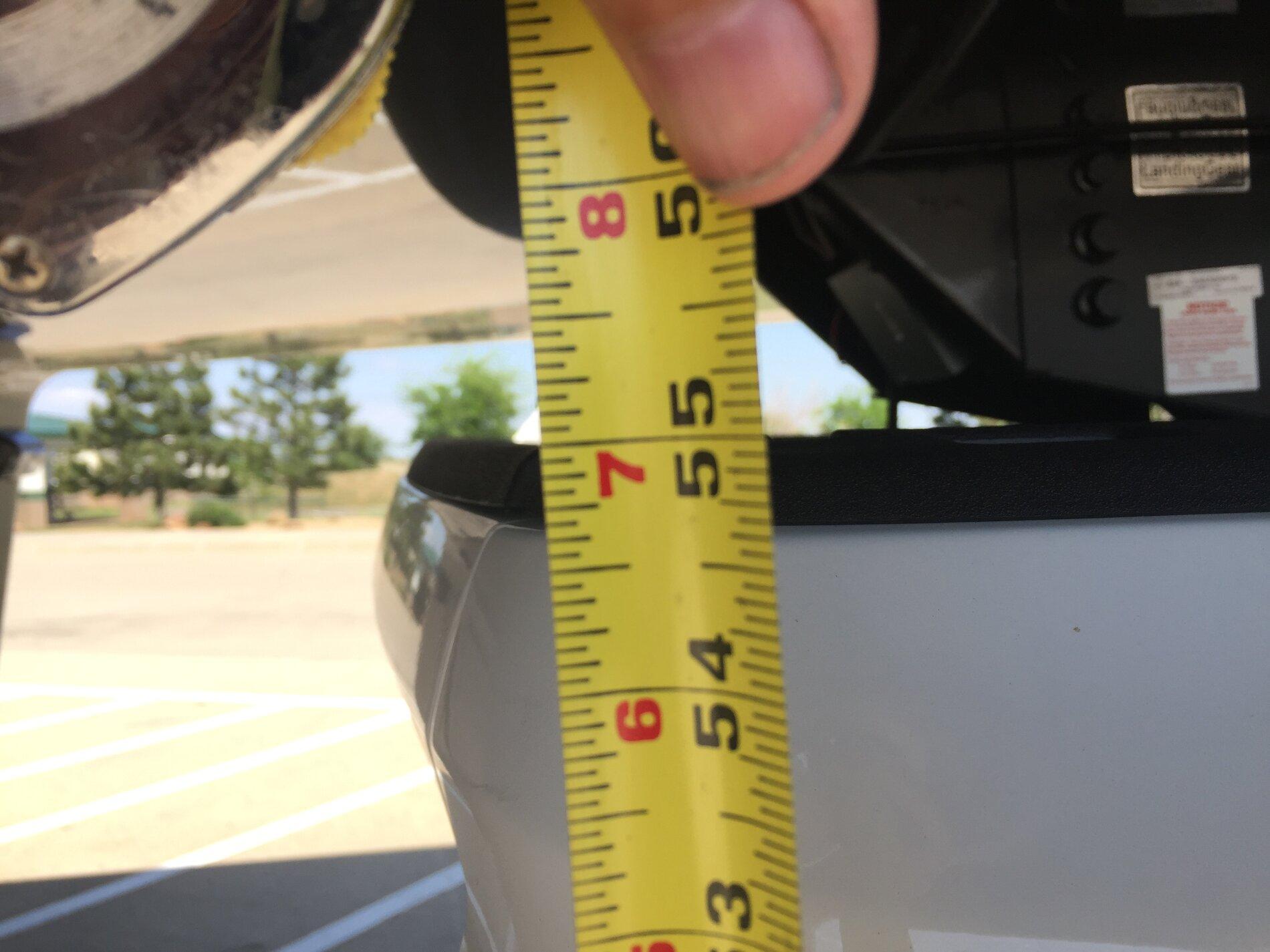

NOTHING wrong with mine staying in ALT, it allows for a near level ride. If it rode a bit better being off the overloads I would NOT take it out of ALT.
Sensor works fine as far as I can tell. Look at my truck unloaded and with 9,750# pushing down on the rear axle. SAME exact ride height.
Back in the early years of Rear Air Ride there was NOT an issue leaving it in ALT.
I've seen those pics 100s of times, still doesn't explain it. The whole point of having the air suspension is variable spring rates. Lower for when empty, higher for when loaded. If your truck stays on the overloads when empty, you don't get the benefit of a nicer ride.

Just looked AGAIN, my truck is setting on overload rubber bumper at front of tires. Top of bed is EXACTLY 55" at back corner just the same is it was in pic below with full RAWR.

my ride height will increase if I turn off ALT. If I add full RAWR the height stays the same.
