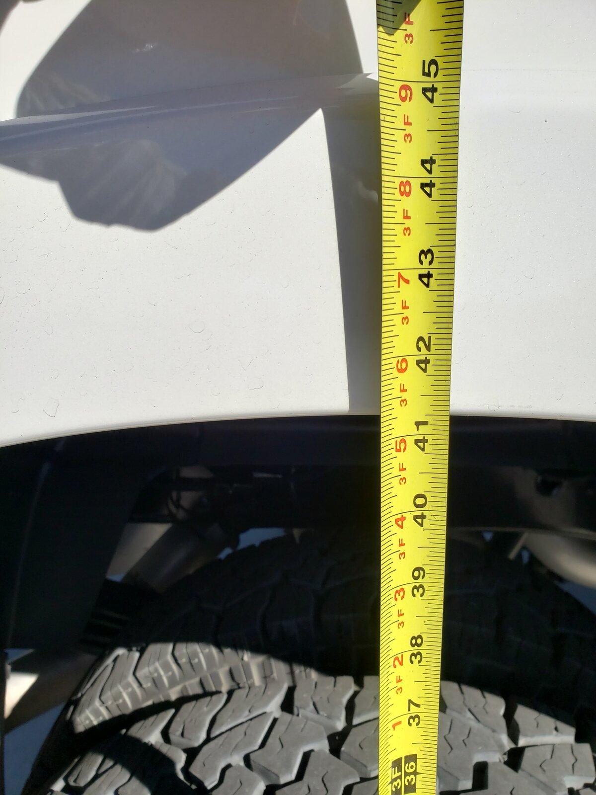

My DRW to fender opening with stock size Michelin’s with 1/4” tread left is 38.75”.
this is ALT ride with overloads touching.
I assume SRW trucks would be a bit taller?

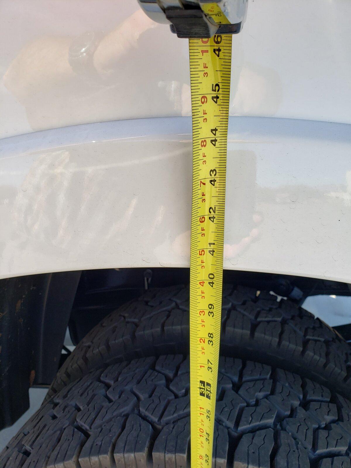

This was sitting on a scale pad, about the flattest, most level slab I could think of. The truck was idling, so the system was active. I have measured it from a bit under an inch, up to 1 1/4. It's visible just standing behind the truck. This started when they did a RRT/TSB reflash for the air suspension. Ride quality changed, and this droopy drawers condition started. Doesn't make sense, and they all say "it's impossible", but I am here to tell you that is EXACTLY what happened.
