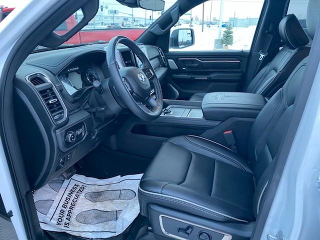

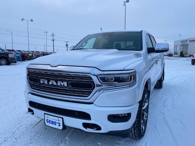

Hey Mule, any updates on your Ecodiesel? Thinking about leasing one for the wife......the local dealer has two beautiful Limited 3.0s on the lot and they want them gone.
Looking hard at this one today....going to see what they come back with. Might be time for me to roll the dice on an Ecodiesel!
