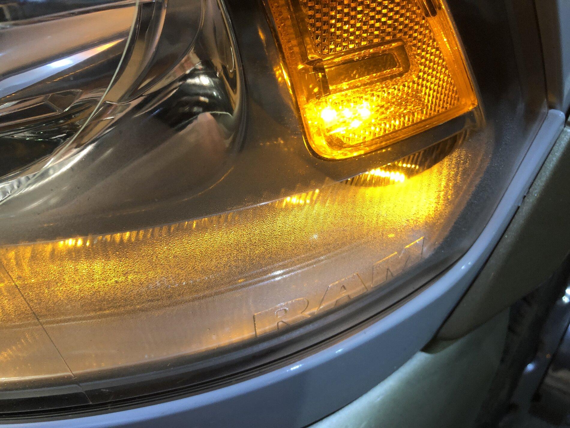

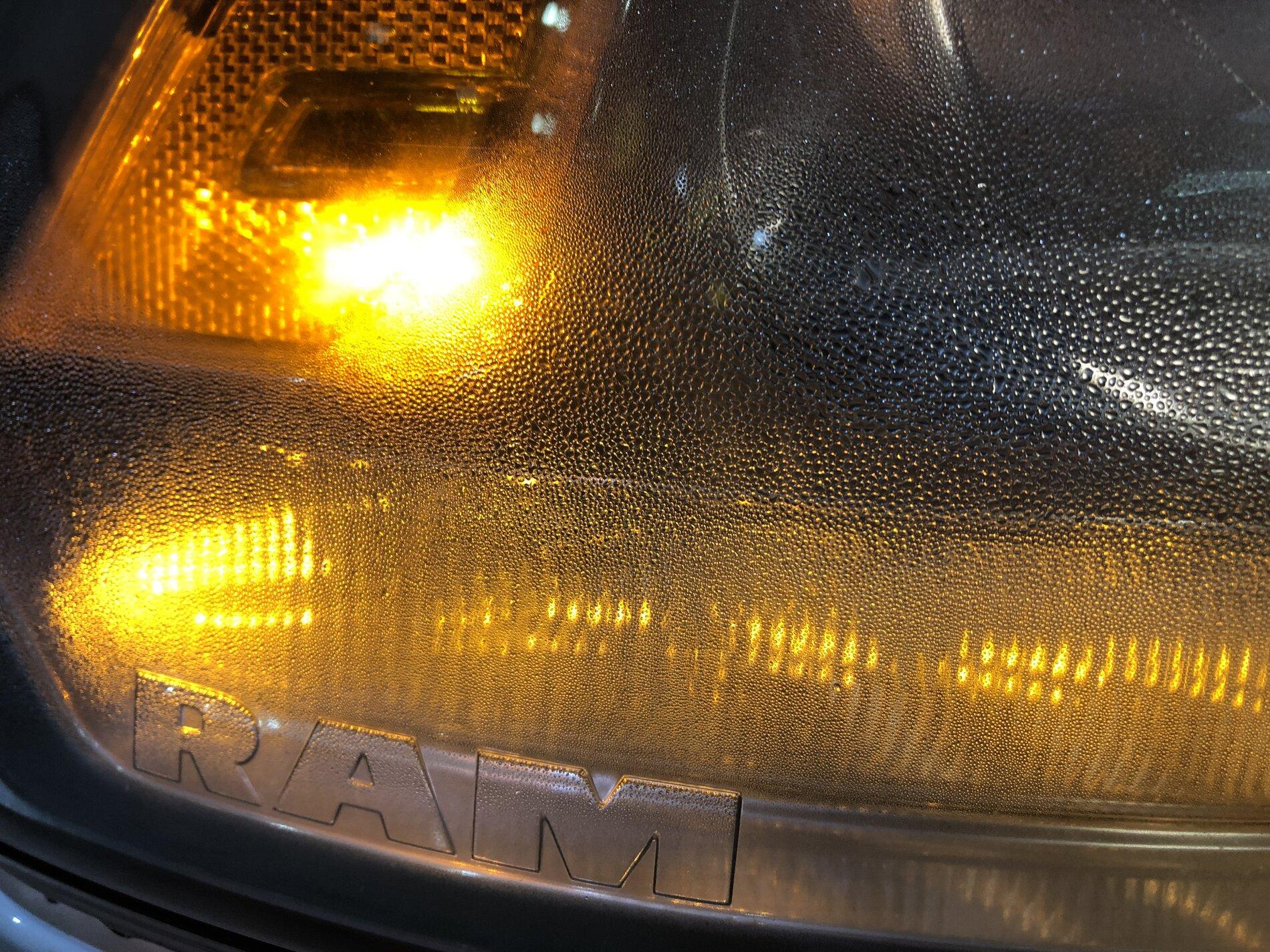

I will be getting both of mine replaced under MaxCare as they are getting moisture inside.
