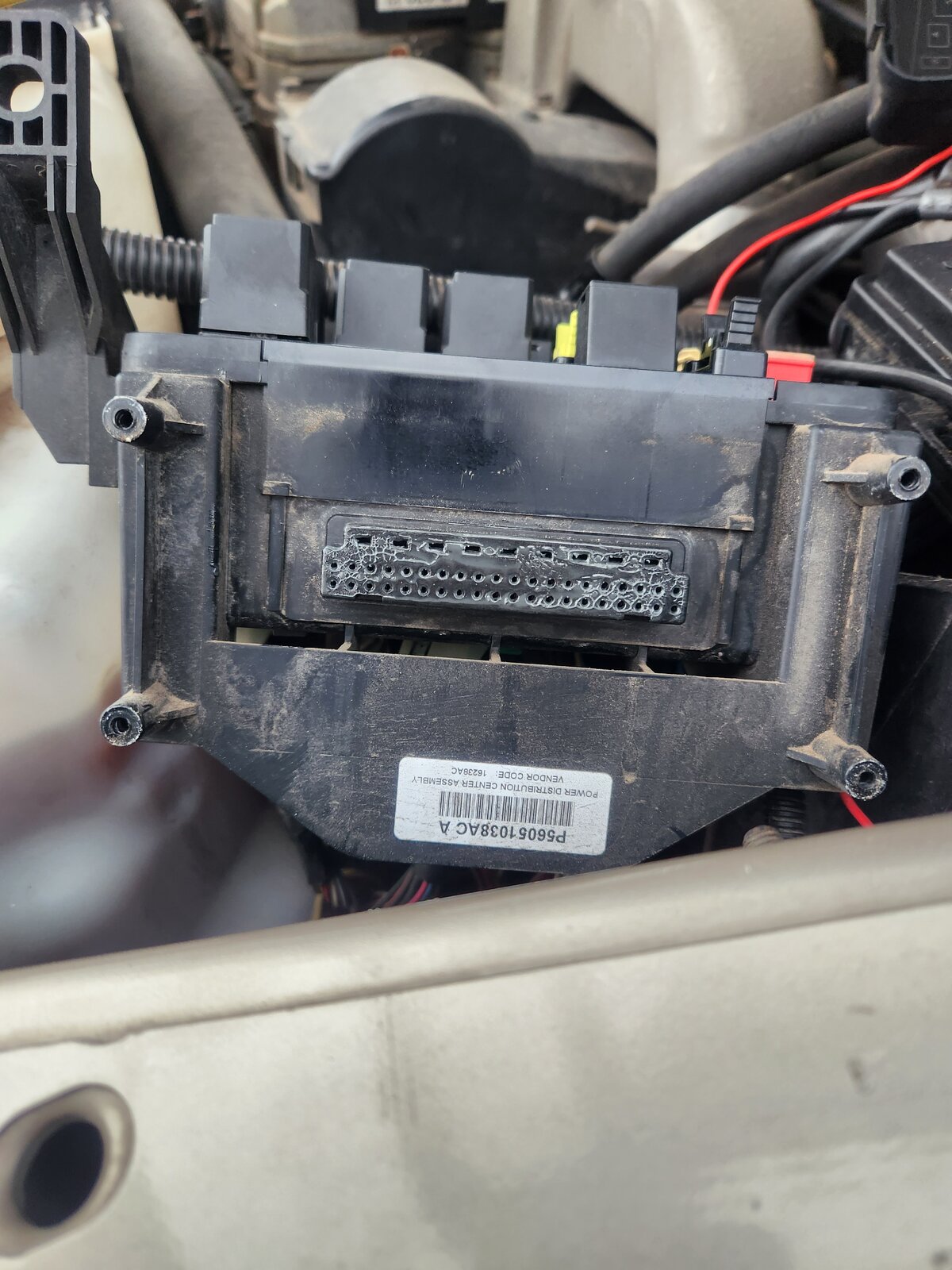

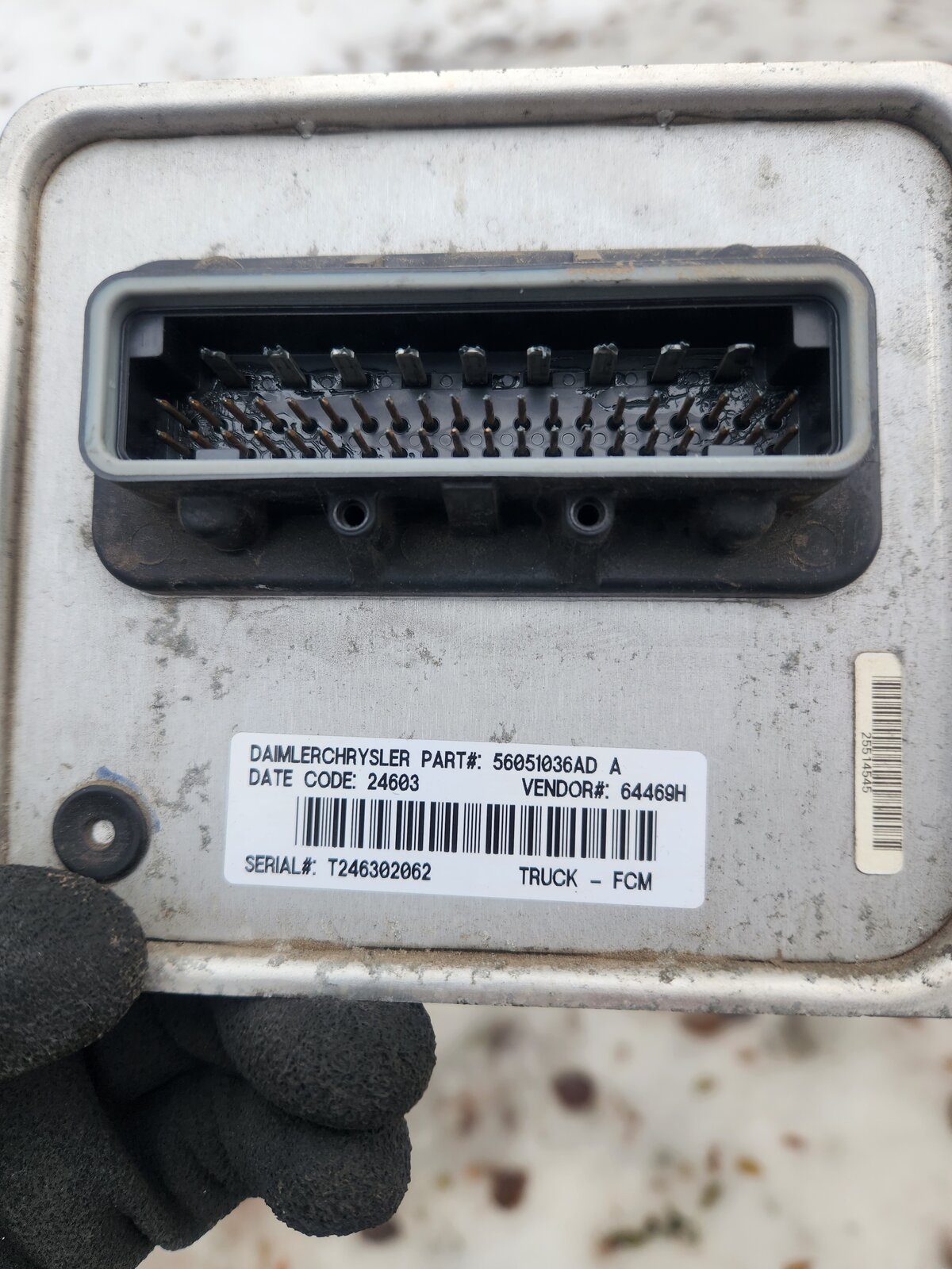

OP - In case you're still working through your headlight issue, I've tried to attach a couple of pictures that may help you visualize the potentially problematic connection.
One picture is the fuse block side of the connection. The other is the FCM side. I mistakenly called it the BCM in my earlier post. I hope I added the pics correctly.
As mentioned earlier, clean the connections with some electrical cleaner. I cleaned the connections up with some gentle use of emery cloth, then electrical cleaner again, and then a sparingly light coat of dielectric grease to help keep corrosion at bay. Last, I experimented with spacing and found I needed 2 washers under each screw securing the FCM to the fuse block to get a reliable connection.
As Ozy mentioned, also check the connection in the fuse block for continuity. The power goes to and through the fuse block, then through the FCM, and finally out to the bulb. The FCM is a gatekeeper, so if you have power through the fuse block to the FCM, but not out of the FCM, you will have to determine if it's a connection issue or if your FCM is malfunctioning. Likewise, if power in but not out of the fuse block, the issue is likely a connection inside the fuse block.

I cleaned all grounds I could find and pulled the FCM and sprayed with contact cleaner. I then put 2 small stainless washers to bring it out to another contact point and headlight now works. that seams to be a poor location for the electrical but its worked for 250,000 miles so must be ok.
