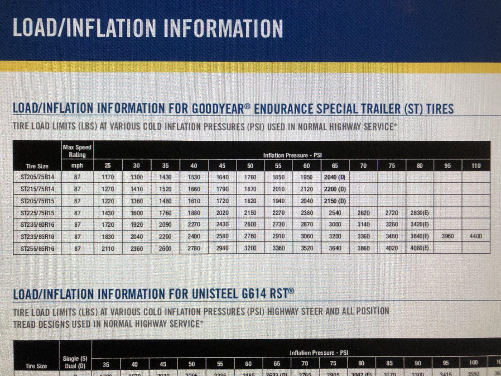

Friends,
I'm not sure these GY are Endurance because every where I read about them, there is no mention of a name. And to the best of my knowledge these are exactly the same tire that came on my RV. What made the decision to keep with them is how well these have worn over 4 years and at least 30K miles. My wife says we have way more than that, and shes likely right. They have 16/32 tread from the get go.
Our RV unit is heavy at 21KLbs and with 16KLBs sitting on the axles with them. I have to say storing our rig inside the man cave goes a long way in preserving them. They have been through some really terrible roads across America and that's pretty remarkable.
For me, this tire selection exercise has been informative for me, especially the tier group thing. I chose that article to post because it's fair in its representation and disclaimers.
Cheers, Ron
Your tires are NOT the ENDURANCE, here is a list of what they sell and weigh ratings.
My new 5er came with 15 inch Goodyear Endurance tires. I bought it in OR, pulled it to TX and ordered 16 inch rims with a 6 lug pattern. The trailer now has Michelin Defender LTX/MS tires, the same as the pickup. With the two spares (truck & trailer) I have 12 tires of the same size. I don't have to worry about speed rating, but I drive 57-60 mph when towing. I hate sending any more money to the oil companies than I have to.
IMHO you did not do your research. They have a 87mph speed rating and a STELLAR record.
