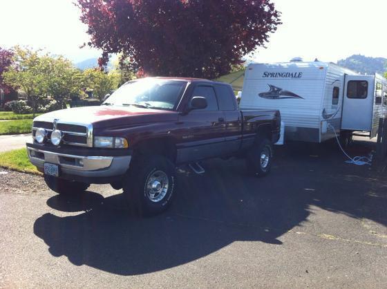

My '01 bought in 2004 with 31k on the odometer, ow has 162k. Pulls my 30', 8000 lb travel trailer well with my mods up over Mt Hood. Mach 1 injectors, Smarty on 8, Drag Comp on 3, runs nice. Still has stock HY-9 so that is something I'm considering changing out for more air. Just dropped a few thousand $$$ at Rips on head gasket, front case oil leak, ball joints (3rd time), rear brakes, assorted maintenance items along with twin Optima red tops. Ouch but it's paid for and does it all, drives like a sports car, has killer stereo, sunroof and everything I want it has.
What size tires are you running? They look well balanced with the truck. How come you run your Smarty on 8? Do you get added timing out of your Drag Comp?
Thanks. Tires are BFG Mud Terrains 315/75R16.
Run Smarty on 8 because the Comp takes care of the timing, correct.
