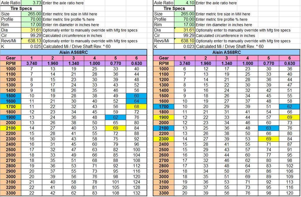

As for the OP question on the rpms see the chart below.
This chart is for the Aisin AS68RC used in the earlier cab and chassis, but the two O.D. ratios are the same. So you can see for your self what RPM's you will be at for any given speed and gear. With the AS69RC that is in the new trucks have lower first gear ratios I'm pretty sure.

I can tell you from personal experience owning a 11 HO DRW with 3:42's that if I chose anything besides 4:10's it would be 3:42's WITH AISIN trans. Fact is the 3:42's in 5th is the same rpm's as 4:10's in 6th. I towed 29K combined with the 11 and the ONLY issue was getting the load rolling. With the 3:42's and Aisin you would get the load rolling, good rpm's at 60 and great solo mileage.

We will be towing to Arizona soon and will be able to get a good feel for towing 12,400 pounds with a truck that will weigh 8600-8800 ready to tow. In the three short 100 mile test tows it seems the 5th gear in tow haul is going to get the job done very well towing 60-63, and she still has the long legs to cruise at high speed bob-tail. And I have gears for towing slower now when required, without racing or lugging the engine. I think RAM got it right for the SRW trucks with 3.42's!
OP's only wild card is his desire to install larger diameter tires. Working with the tire/speed/rpm charts he should be able to figure out if 3.73 put him between desired gears or put him smack on what 3.42's do now. Which is not a bad place at this weights.
