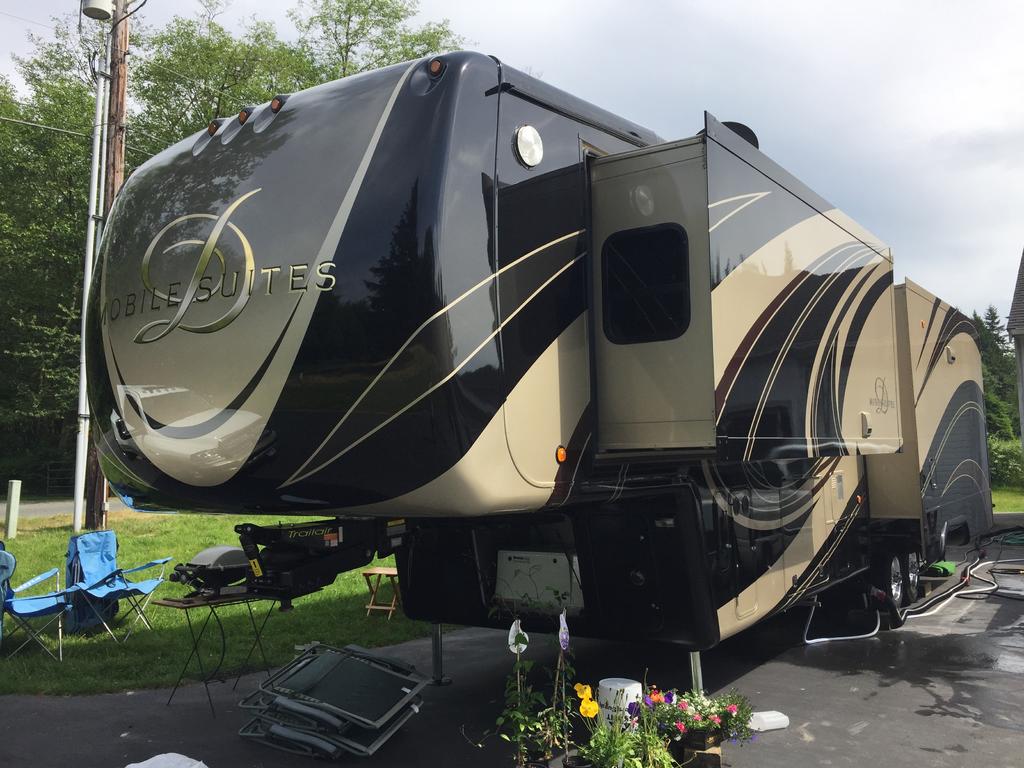

HA, yea kinda need it with this monster in tow!
What's the dry weight on that monster? Pin weight?
The dry weight was 18,0??# but I don't believe that! I am assuming it was weighed before many things were added, 6500LP Gen and prep, washer&dryer. The pin weight is about 5,500#. RV total weight is 23,000#
Front axle is 5,460# the rear is 9,580# and trailer axles are 17,500 combined. Combined 32,540#

Dang that is a monster! I assume 17.5 trailer tires but what size axles, 9k?

Must be very luxurious inside. I thought my Raptor at 13,800#'s dry and 1,800 pin weight was heavy.
You can go to RollingRetreats web site they have a bunch of pics on there of the inside. Scroll down to "our newest happy customers" its the one being pilled by a red Volvo HDT.

They are MorRyde IS axles and I believe are 8K. The tires are fine with 4,806# per tire rating. I will probably have a third axle added.
The 8k axles are big and tough, but yes, I think the factory under GVW this trailer with all the options. To add 9 or 10k axles would be fairly easy v/s a third axle. 235/75x17.5 tires are rated 6k each if you want even more overkill.
