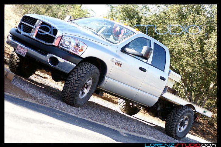

Theres been some updates to this build, and I' pretty excited about the new 1948 Spartan Aircraft Trailer that I'm going to modify and mount on the bed. Pics to follow.

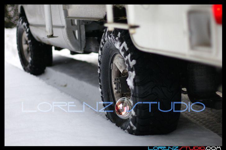

I'm now running 19.5 Vision wheels with new Sumitomo ST918 245/70/19.5 tires and a 4540lb rating per tire. The recaps were not cutting it and I could NOT get them balanced after multiple times to the shop. I loved the recap tread pattern, I just couldn't get the to stay balanced.

I'm now running 19.5 Vision wheels with new 245 tires. The recaps were not cutting it and I could get them balanced after multiple times to the shop.
I am very happy with my Vision's. My Toyo's balanced out great with Counteract Balance Beads.

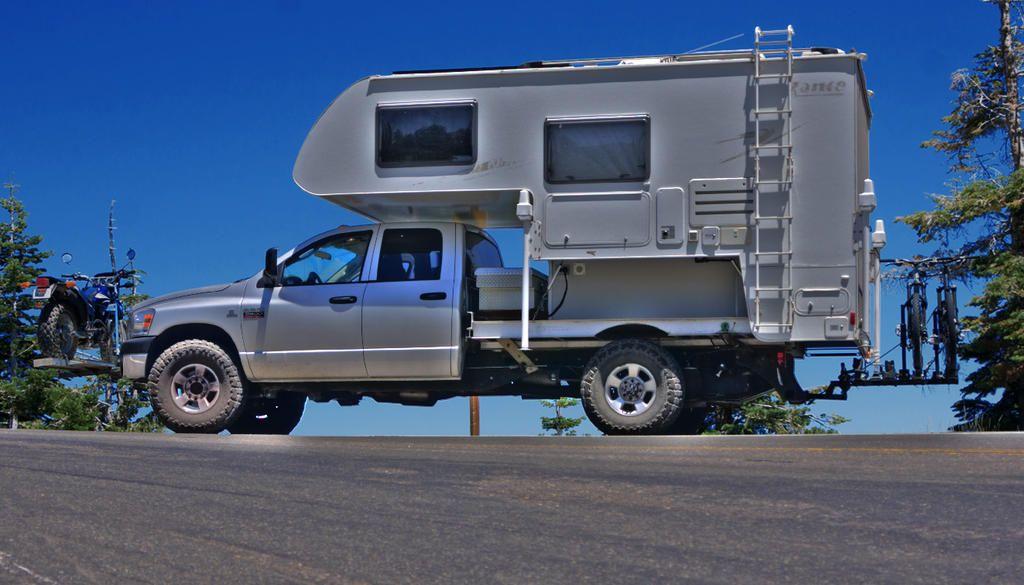

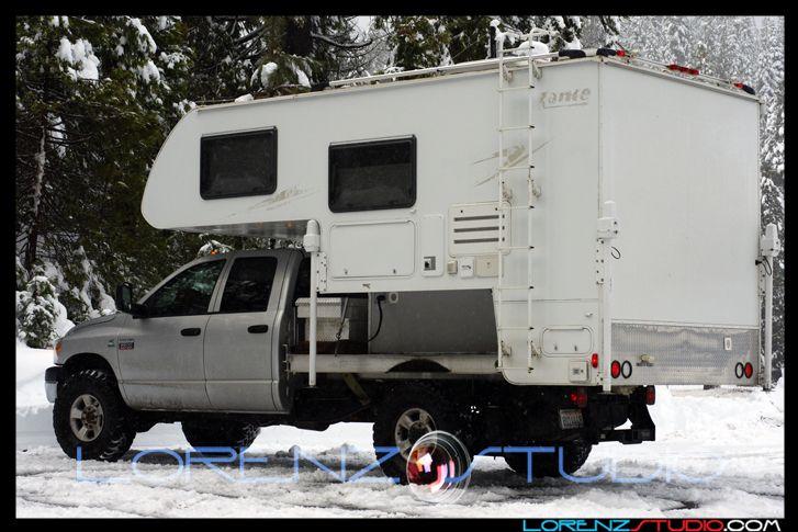

Here's some old images I ran accross with the Airbag rear suspension and 37" Toyo's. No lift or leveling up front for this tow beast, though I will be upgrading the shocks to our Camper and Towing Fox's with special valving to reduce sway when loaded.
