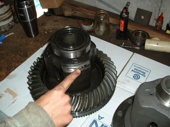

While changing the diff fulid I noticed 3 hair line cracks in the pozi housing. Looking at the end that has the helix gears exposed you can see a cracks between each set of gears. Now the truck is getting its third pozi. I made sure to get the new updated versoin, I'm not sure of when they updated it but I wanted the one the 2012 towmax had. I told myself after the first one went bad I would put an open in it. After looking at it for awhile I didn't think it would last as long. The helix type just has a lot more gear surface contact compared to a set of spider gears.
Anyways I just thought I would show you so you can make sure to check when doing a service.

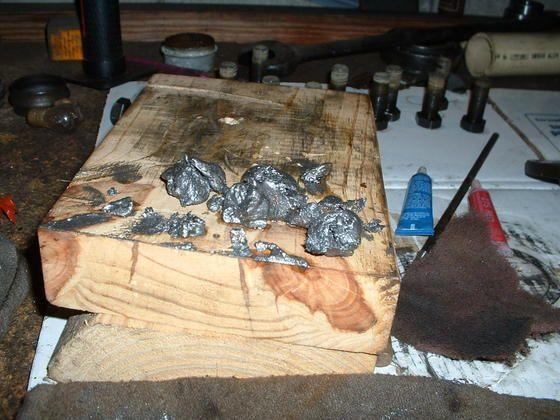

The truck pulls a goosenecks I run from MI to TX a lot. It has has a trailer on at least 80% of it's life. If it isn't working it's not running. It does make continues long runs 800 miles a day. I try to keep the load at 18k or less, it has had a few heavy ones. When the first one went it had 55k on it so it was done under warranty. I did some research and found a grear lube that helped alot. These call for an lube change every 15k if you are working them hard, they need it. Because of the way the helix gears are forced against the housing they make the lube look like metallic paint. I dont see this in the average grocery getter or something that tows a 9k boat to the lake twice a month. I do believe it could use a bigger axle. But we have had big trucks in the shop with this type of pozi and seen the same kind of metallic like logging trucks. Heres a picture of what came out of the axle tubes from the first pozi the first one looked realy bad and a shot of a load from TX.

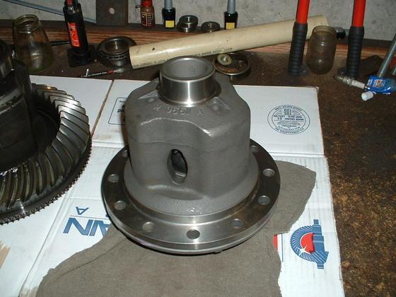

The sceond one went over a 100k more then the first one. I think the lube helped this. The first one wore out the pockets that the helix gears ran in. The sencond one housing cracked. The new one has more housing. They must have knowing it needed more meat for the higher tow ratings.

Yes they are still helical the new one I have picuterd on top is for a tow max, I have the tow max rear cover also. With that pozi I now have the tow ratings for the size loads I tow. At least as far as the rear axle is concerned.
I think I posted photos of a diff unbolted so you could see the helical gears. Without going back to look, I'm thinking you could remove the helicals and run it like an open diff. That is if you don't need the posi.
I am not sure but I believe If you were to remove the helical gears you would have no drive at all. The gears that the axle shafts slide into get thier drive from the helical gears. The helical gears are pulled buy the housing, they ride in pockets. Because of how helical gears react with each other they will only let one spin so much faster than the other. That's why one tire can spin at a differnt speed in a trun. But if one starts to spin a lot faster then the other it will create drag and start working like a pozi. The pockets that the helical gears ride in is where most of the metallic you see in the lube comes from. The larger the loades the more they wear. There is a great deal of force on them pushing against the housing, I think this force helps to creat some of the drag that slows down the helical gears to help make the pozi affect. Now I might have this wrong the last time I had one of these apart was in the 90's it was a trutrac. We ran them in the front axle of our mud trucks they didn't hold up well on a set of 40" tires.

Went back and looked at my photos. You're correct the diff will just spin around the axle shaft gears. The helical gears act as the spider gears in a standard open diff. Seemed like a good solution at the time!
