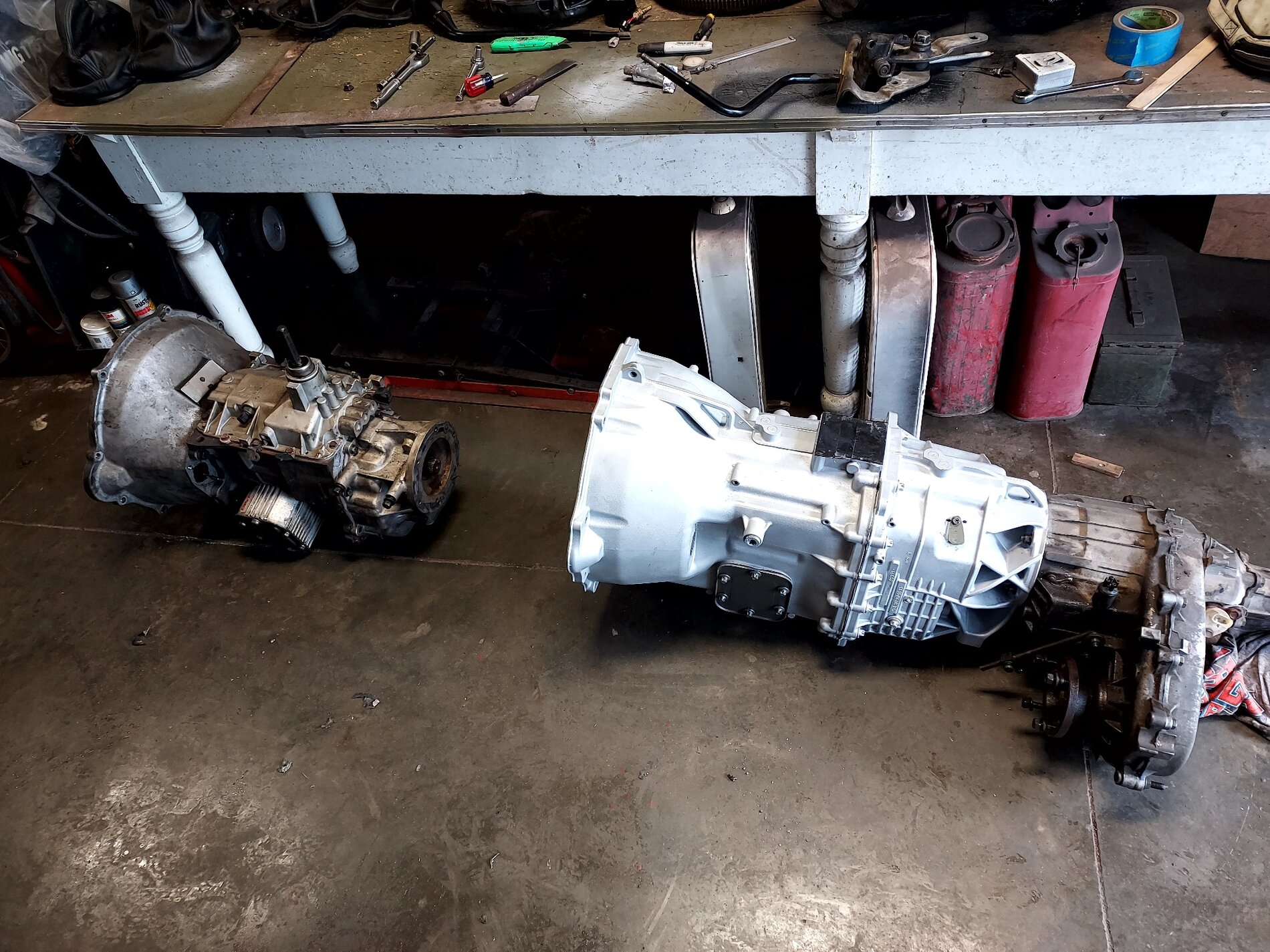

Juuuuust a little size difference!
at least looks like you can reuse your PTO fast coolers?
I believe so. It does require a different "attachment kit" (bolts I'm guessing). I may have an exhaust clearance problem on the passenger side. I'll put them on after the transmission is installed just to make sure they will fit.

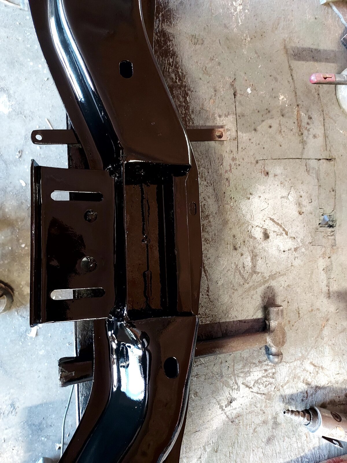

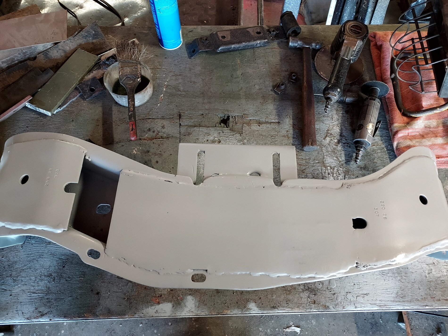

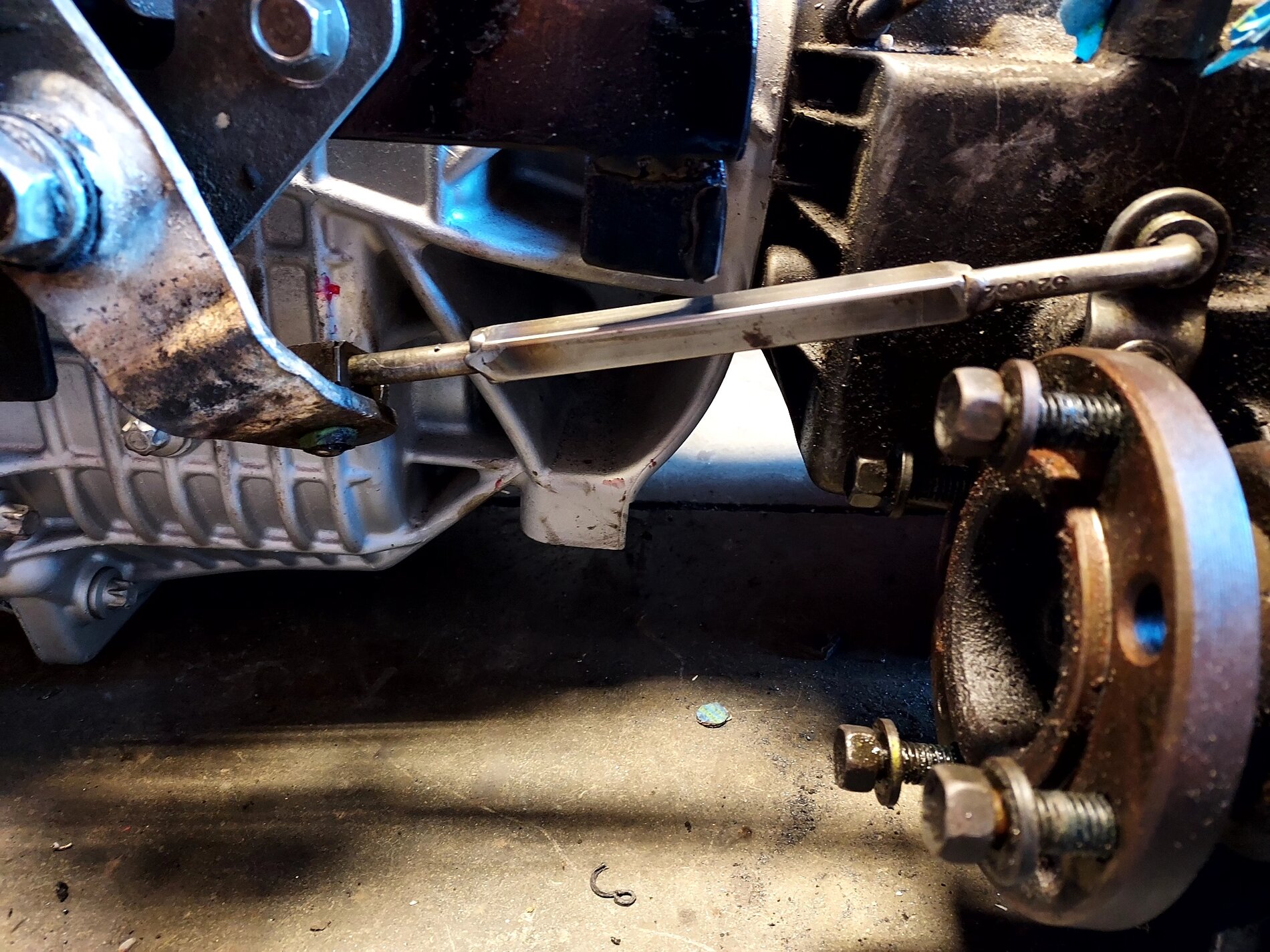

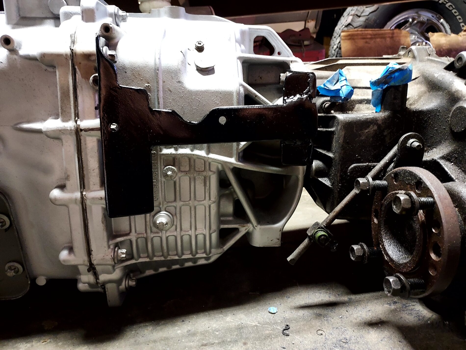

G56 TRANSFERCASE SHIFTER MOUNT.jpeg I have completed the mods to the crossmember and made the tcase shifter mount. I have been distracted with getting my GPW ready for the Willys reunion this Friday. Did a test tow with my 52 Willys Delivery and broke the mainshaft in the transmission!! I think God is trying to tell me something................... View attachment 133688
Thanks Gary. I test fitted the crossmember to the trans/transfercase and had plenty of clearance. I have the new SBC G56 OK HD clutch installed.
