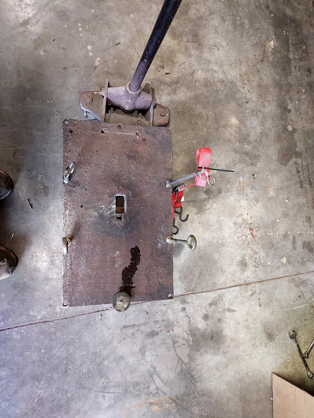

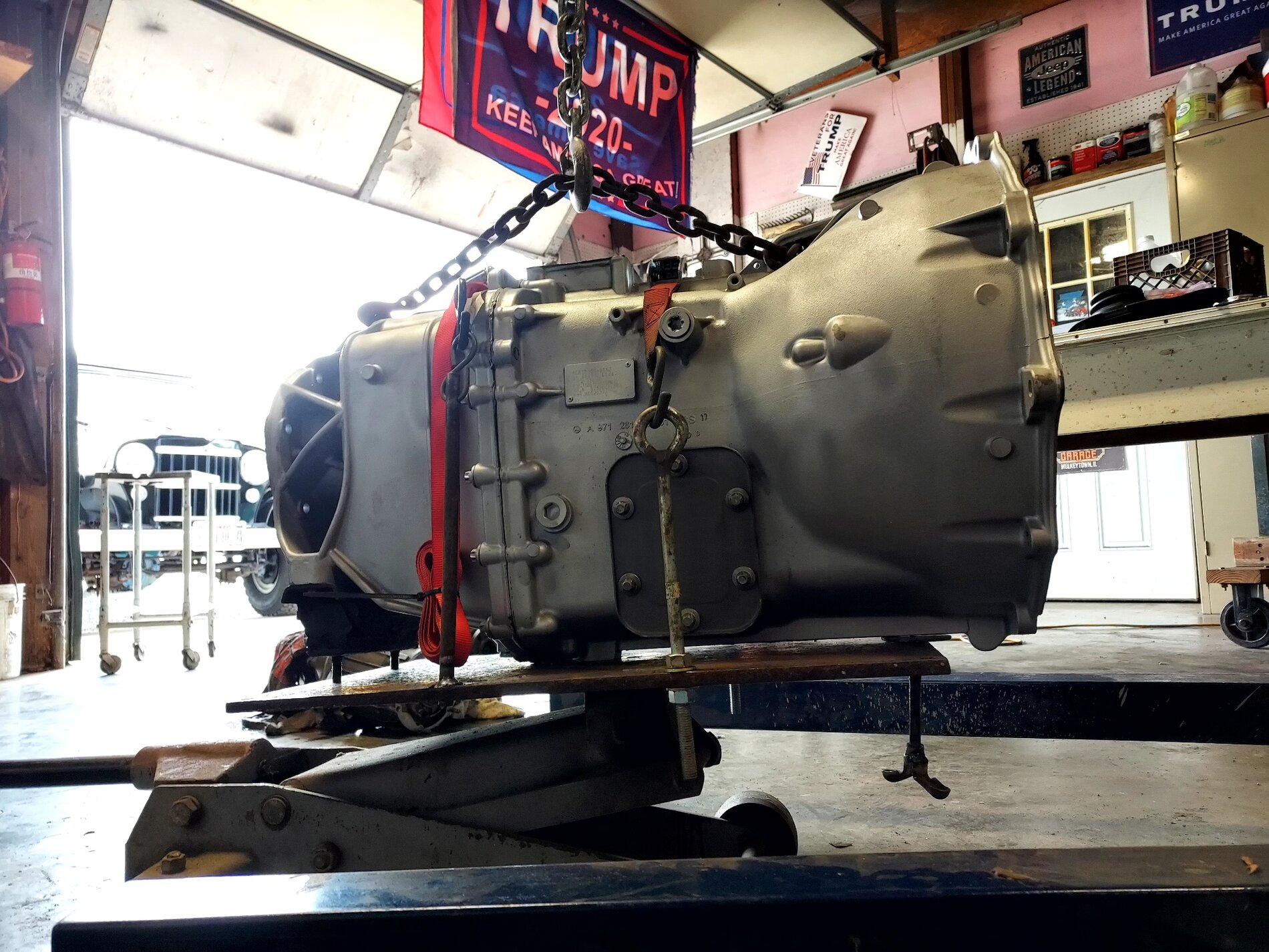

Well, I got back from Ohio a day early and decided to install the trans. I spent a few hours fabbing up a plate for my floor jack to be able to do it by myself. The hole in the plate is for the nub on the trans bottom to sit into. By installing the trans mount, it was able to drill two holes, engage with the plate, and not let the trans slide. The straps are just for extra safety.
I slid the trans under the truck and lifted it with my engine hoist through the passenger door. I was almost able to get it under on it's side without jacking the truck up. I ended up raising it a few inches on jack stands.. I then slid the jack under the trans and lowered it onto the jack. No major drama.
I did end up having to cut off the front lifting loop and beat the pinch weld about half way over. The real ***** is getting into the splines and pushing by yourself. I'd say an hour of jack/tilt/push/spin/cuss until it finally slipped all the way in. VERY happy to have that phase behind me.

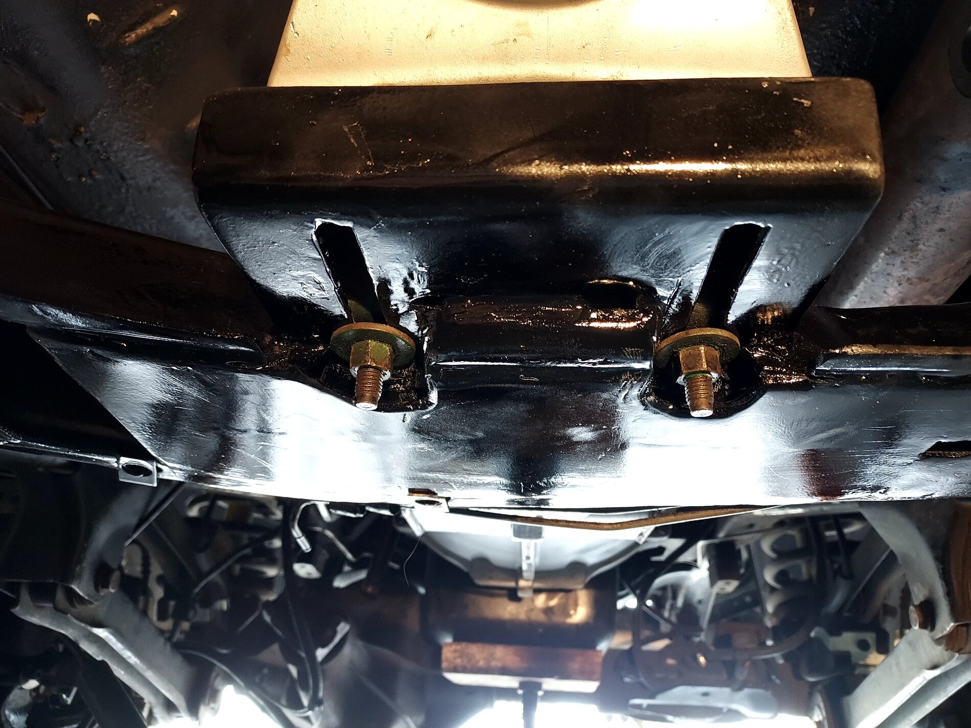

Unfortunately, I didn't leave enough forward slot range in the crossmember and will have to do some more mods to it. I was about an inch short. transmission jack mods.jpeg transmission jack plate.jpeg Not a huge deal, just another slow down................

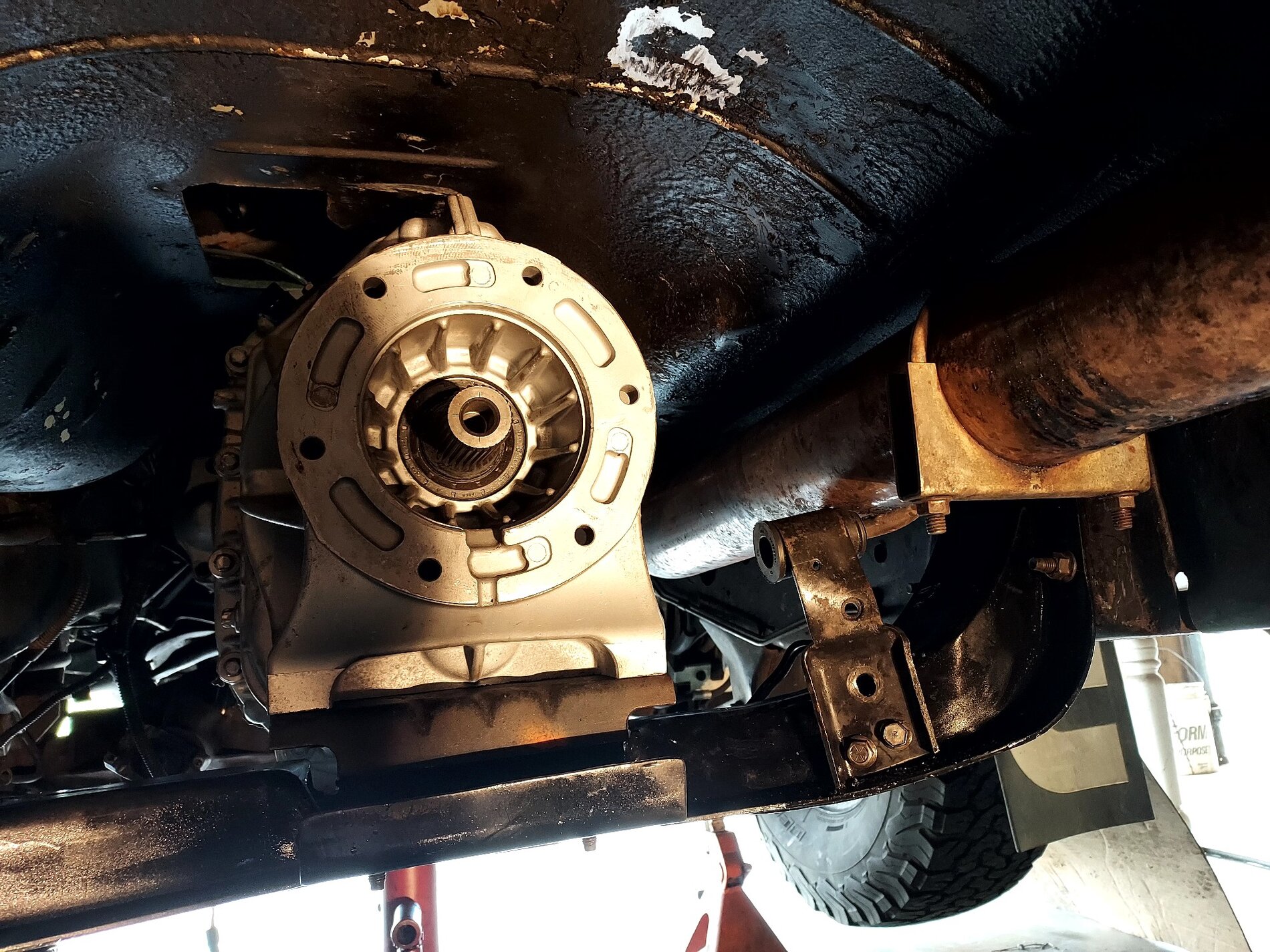

Everything is buttoned up. Just waiting on the driveshafts to come back from the shop. I used an aftermarket shifter that does not interfere with the transfercase lever! I have not put the boots back on yet, because I wanted to test drive first and look/listen for a few miles. Hopefully done next week!
I tapped two holes into the crossmember for the exhaust pipe bracket. I had to lengthen my slots back into the crossmember to mount the trans.
