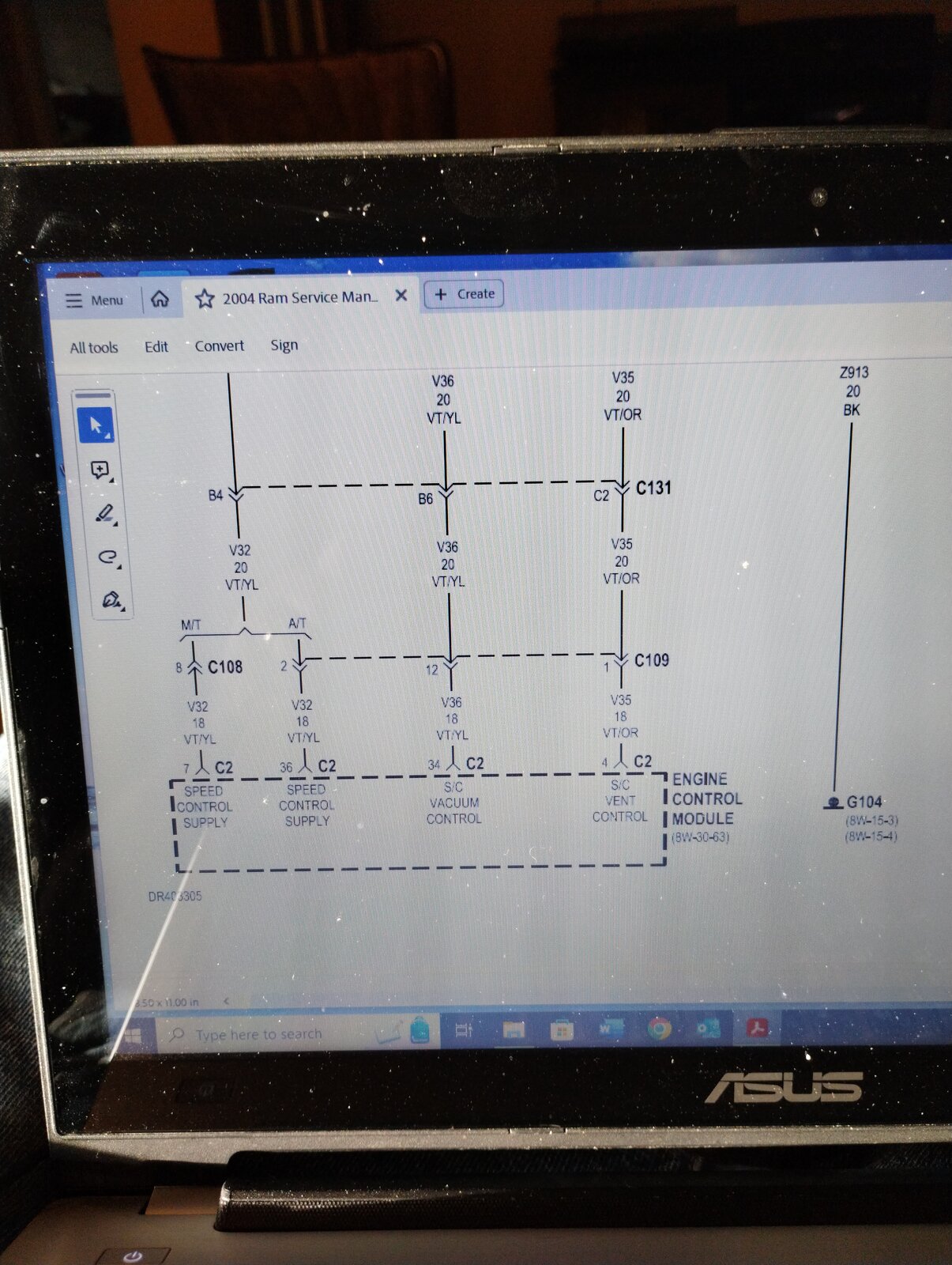

When I installed Timbo's wiring harness it was suggested to move C2 pin 7 to C2 pin 36 to make the crusie work.
So now after 3 brake light swiches I have swapped out, still getting P0572 code without a CEL, I began back tracing wires on cruise supply wire it's VT/YL and right now I'm only getting 4.24 volts at the brake light switch on pin 4. I followed it back to the C2 ecm connector and according to the manual it should be in pin 7 (manual transmission) which is was where it started from, not pin 32 (automatic trans). So is my OEM Dodge Truck manual wrong?
Does anyone know what the voltage is supposed to be at pin 4 on the brake light switch VT/YL colored wire?
Thanks
Kyle
Speed Control Supply on an A/T ECM is pin 7.
Speed Control Supply on an M/T ECM is pin 36.
Did you swap your A/T ECM for a M/T ECM? If you moved it but you’re still using the A/T ECM, could be your problem.
