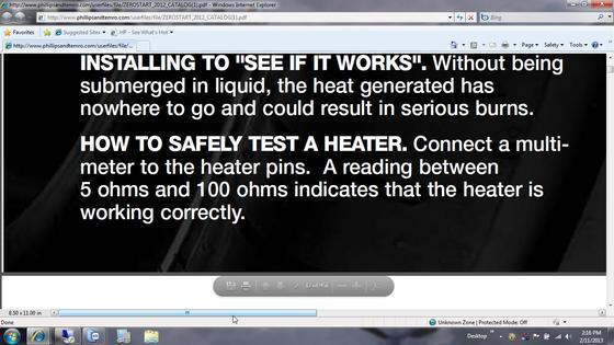

Easy way to test the frost plug heater, per Phillips Temro (Zero-Start)

Have him stick his ear under the right front fender after he plugs it in. About 5-10 seconds later, he should hear it "cooking":)

After he plugs it in have him either check the temp with a heat gun, right at the block heater, or touch the heater surface after a minute or two. It gets hot quick. The rest of the block takes awhile.
