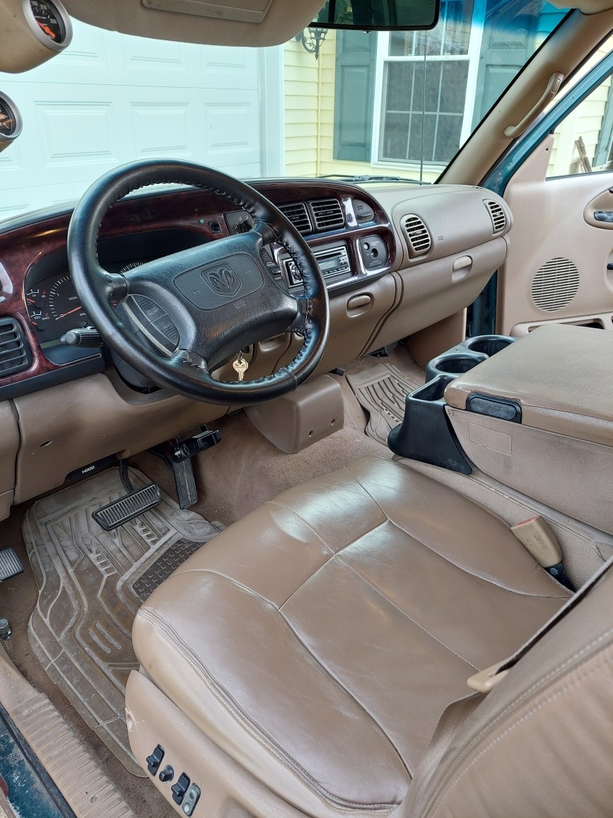

Interesting, my Buddy's is a 98.5 SLT (215 HP) and it has the Pullswitch, but the Operators Manual shows both switches, side by side.
Canadian Modell Truck.
You can pretty much see everything but the headlight switch……
