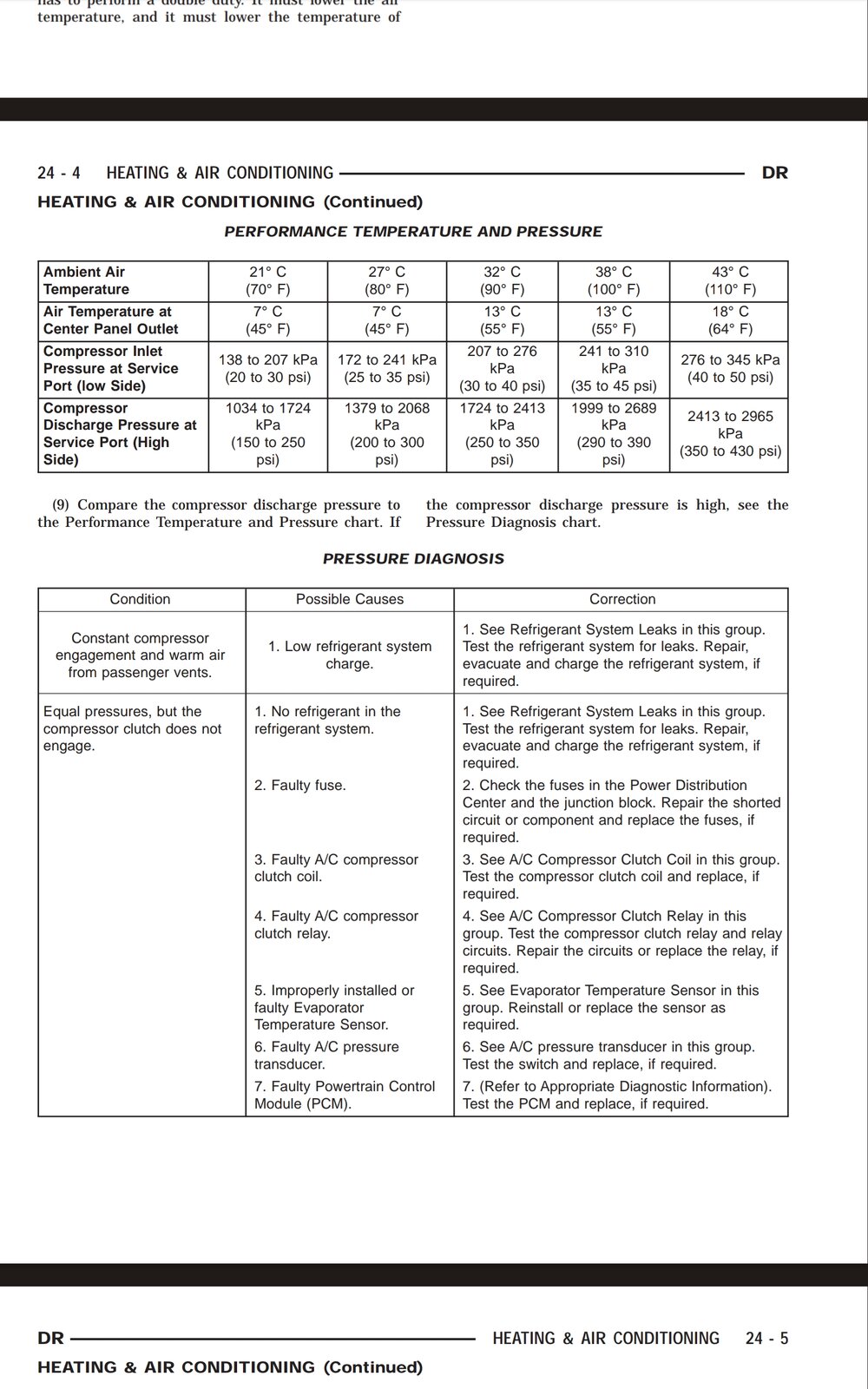

Up to 435psi is within spec.
Mine never dumped Refrigerant, even severely overcharged.
Sanden compressor, not the Hallal.
Hey Ozy
When the pressure starts rising it rises fast. It went over 450 today at an ambient temperature around 95F. Standard Operating procedure from hear on out is watch the pressure for the 1st 5 minutes.
