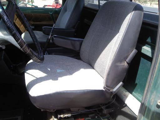

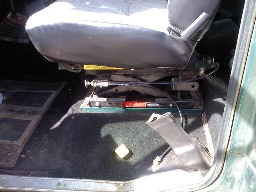

I have a set of Bostrom 710E Air Ride seats in my Ford, they are low profile and work great.
Nick
