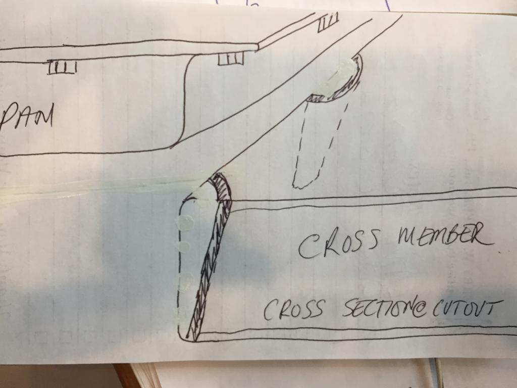

After looking at mine recently I think I will cut 4 radiused slots and use some 1/8" wall tubing to infill. The slots will be shallow at the bottom of the crossmember and deeper at the top edge, this will allow for the easy use of a wobbly and socket! The light bulb has illuminated!!!
My quick artists rendering! IMHO this will be much quicker and be VERY strong. Comments???
Yes, this will work also as long as you have room to drop the pan and slide it out without any crossmember interference. All good ideas which will still require a good penetrating weld to insure it is as strong as originally intended.
