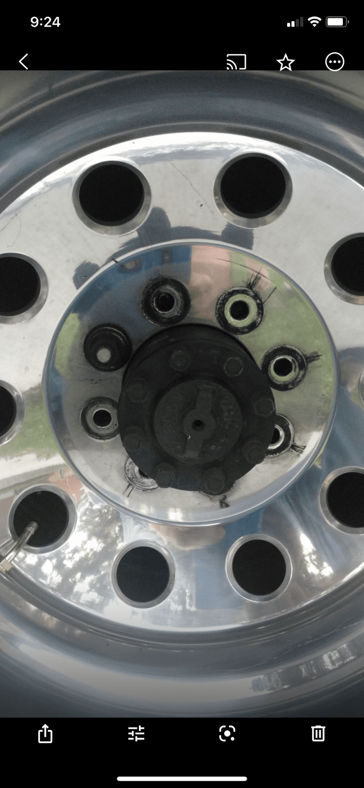

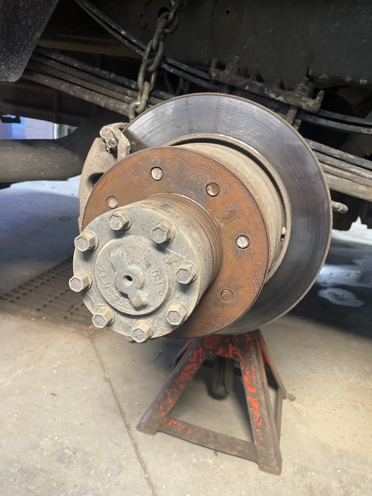

Happened to one of our welding trucks. He was driving down the hiway at 120km/hr, pulled into a side pull out to deal with emails etc. when he put it into drive, the truck wouldn’t move. Absolutely no warning, no vibrations or anything prior to pulling in to stop.
It’s a miracle it happened this was and not while driving at speed.
It’s obvious that lots have been broken for a while and held in by the hub cap.
