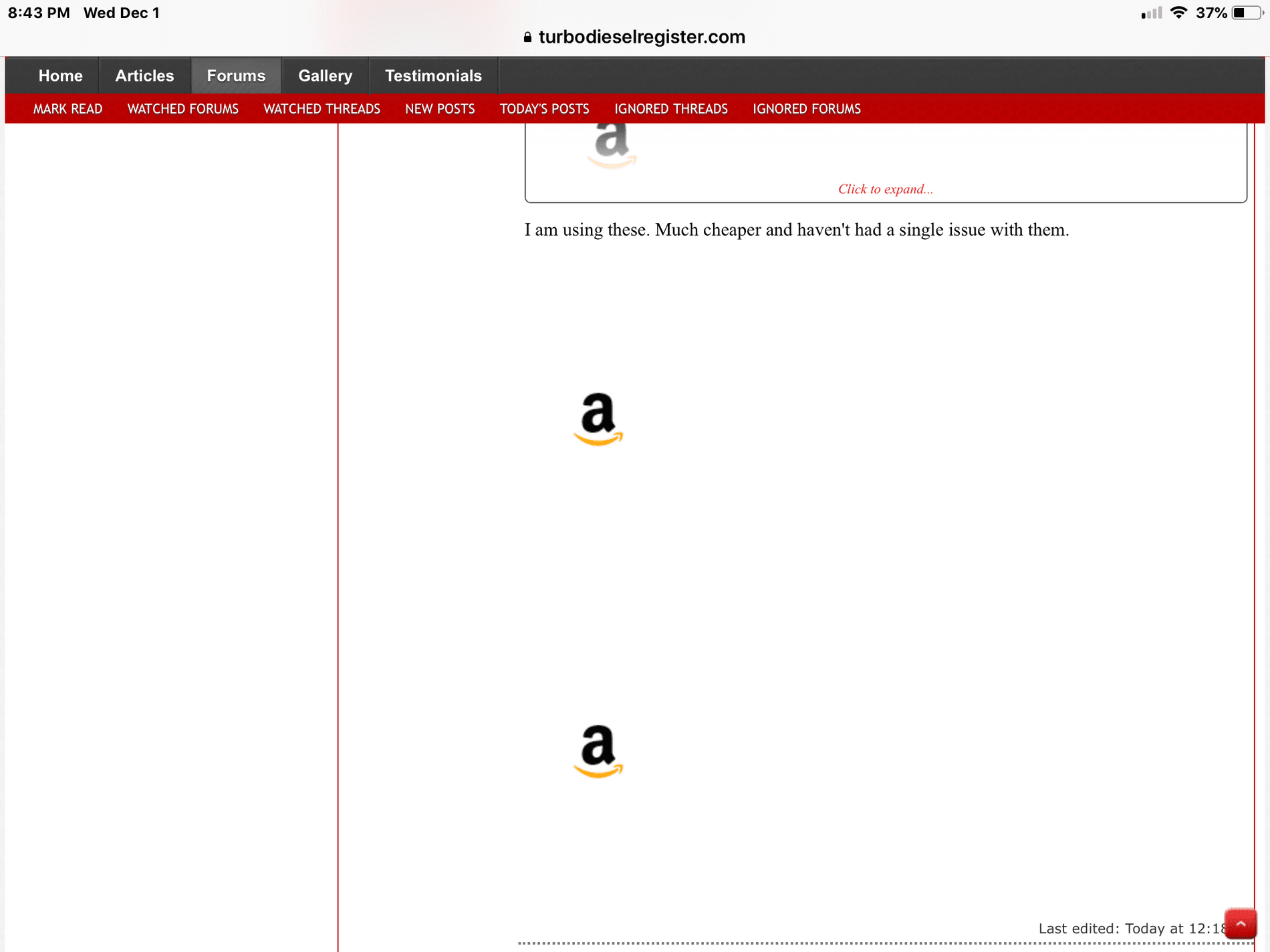

I am using these. Much cheaper and haven't had a single issue with them.
Are you able to do all the same functionality on the PC? Surely no need to spend money if no added benefit.
Yeah, I was going to check them out at Costco this weekend when I go there, the only reason I was going to go with the Samsung Tablet and MX+ was so I could do live data, screen capture, and use it as a scanner for my other non-FCA vehicles.
I think so, but I've never tried it on an android. I haven't run into anything I thought wasn't working.
