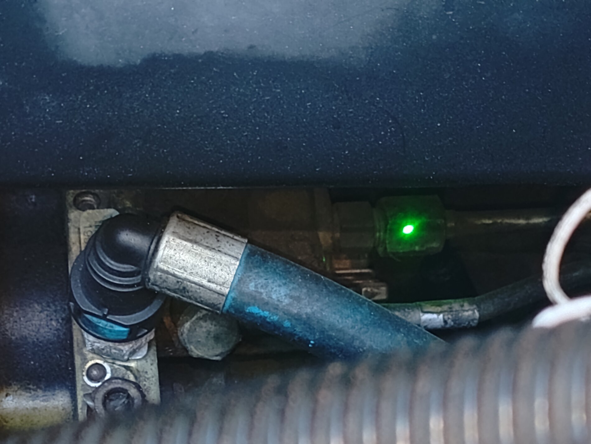

Troubleshooting some hard starting, did a gravity test where you Jack the back of the truck up that abated the issue, that in conjunction with the fact that it matters how long I leave the truck parked means that there's a couple things worth trying first. Like the Cascade overflow valve before running through a couple of other tests having to do with commanded real pressure versus actual real pressure and how much fuel the injectors are returning.

Bonus content would be maybe an illustration of the CP3 the location of this Cascade valve and maybe some general instructions I understand there's a ball bearing involved if there's any seating instructions or torque value or thread group that I need to observe, let's just say I love my tech data.

I'd also love some feedback on the illustration of where on the CP3 the Cascade valve is (an arrow that says "it is this thing stupid" is totally acceptable) Tq. Value / installation lube recommendation and any other instruction. If we have a tech ref from the book and if anyone wants to recommend a source for a service manual for the future I'd appreciate all of the above with my gratitude.
I thought it was what I am hitting with the green pointer but someone said that might not be it.
