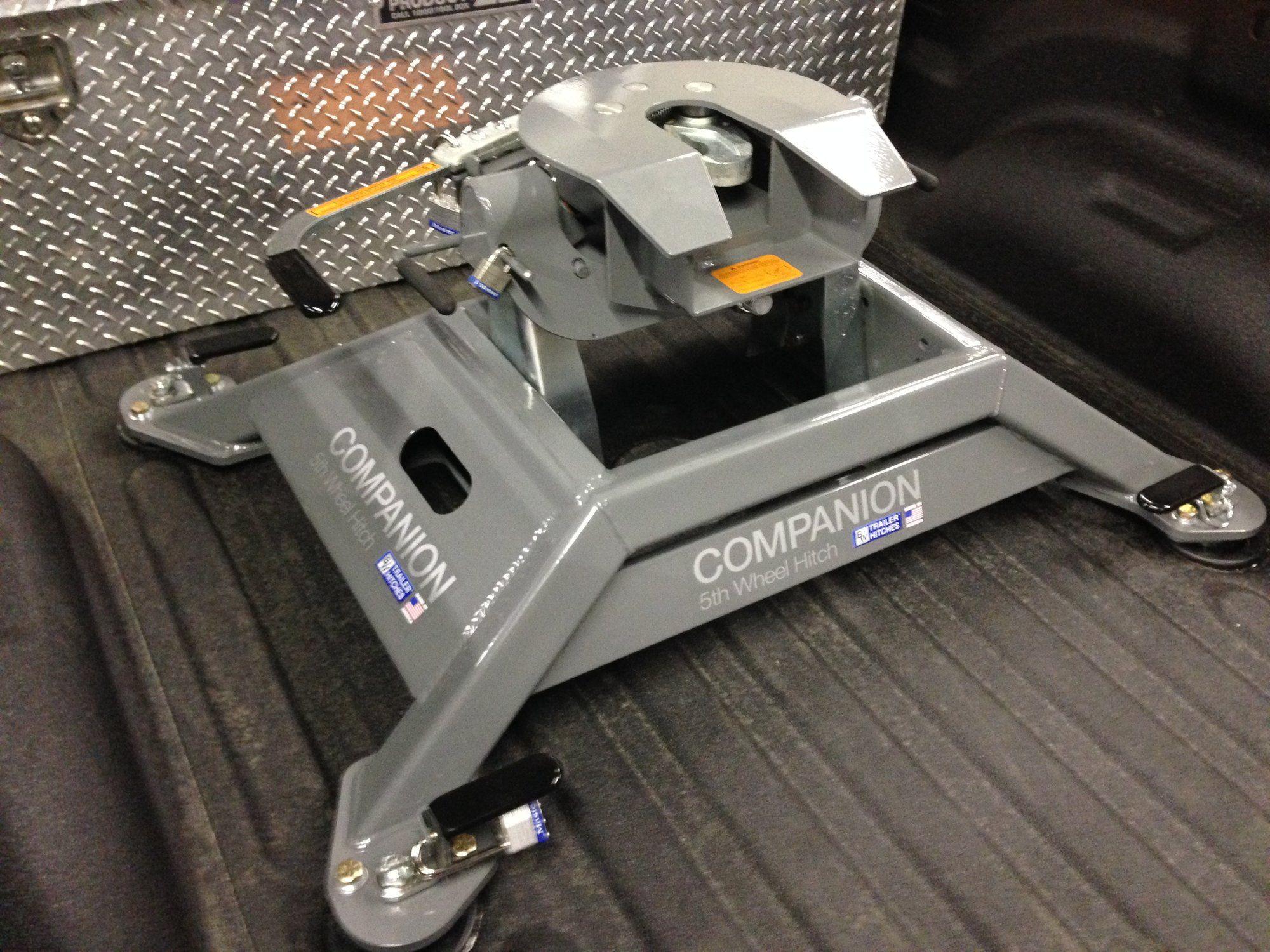

My truck didn't come with the GN or 5th wheel prep, I installed the B&W GN hitch and am using the B&W Companion hitch which uses the GN hole. In the instructions it specifically states it will NOT work with other GN hitch manufacturers due to B&W unique shank design. I wonder if this may be the problem you are encountering .
