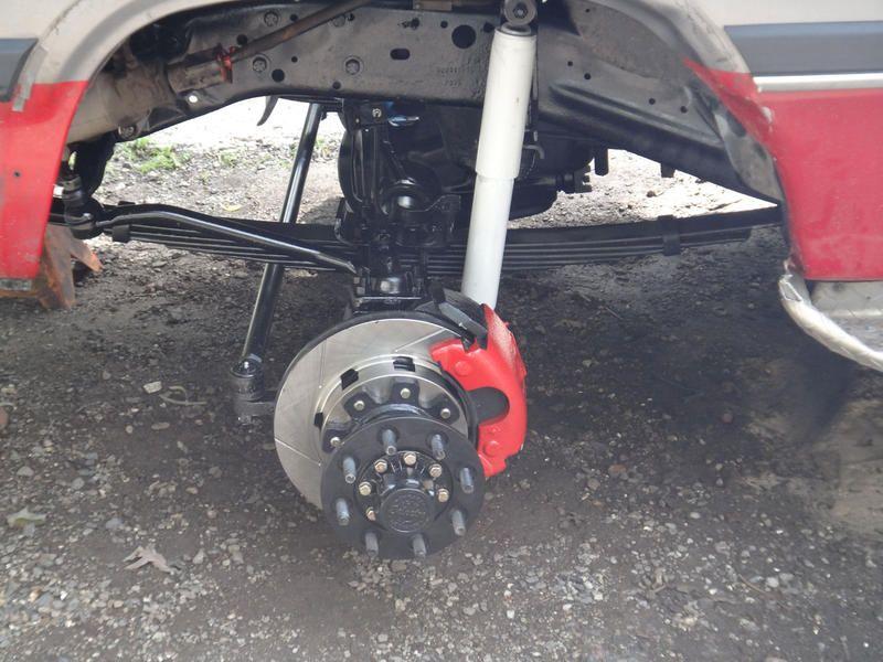

If you go GM, you can keep your outer axle shafts... if you go with a Ford one, you'll have to change your outer spindle and axle shafts. Ford's are longer.
Quad 4x4 has them, but I'm not sure of pricing. They're usually higher'n Willie Nelson in an elevator, but usually have it and will stand behind it. Out of curiosity, I looked on Ebay, and there are several sets there for less than $400..... The boneyards will have them, but be careful, as the internally splined hub is from 90.5 to 93, and the outer drilled hub (with eight bolts, like your rear end) is from 90.5 and earlier, which uses they Selectro locking hub. I guess if it works, do you care?
I have sooo much to learn, sometimes I wonder if you guys are speaking Japanese!! HEHE! I really like the "higher'n Willie Nelson in an elevator" Might borrow that one.. Thanks for all the info, I'm gonna have to get to looking for the hubs I need for the single wheel setup, and pray the weather starts warming up!!
The single wheel hubs are easy to find, I had a hard time getting rid of the set I had, that being said a believe a friend of mine has a set of front hubs that will match the wheel bolt pattern of your rear end, but they do need the old type selectro lockers, they look like this. but are for single wheels and not dulls
My truck is a dully the single wheel hubs have the wheel flange set back closer to the brake rotor, but it dosent matter I had a brain fart for some reason was thinking you had a rear off a 1990 truck, if you had a 91 or new rear you don't want those front hubs, you want the newer type with the warn type lockers.
Boyce Equipment in Ogden, Ut might have some GM or dodge ones sitting around , but really the adapters do work in a pinch
... except the single wheel hubs are available, still.... Ever tried to find a set of 4wd dually hubs? What do you want for them? I may be interested...... :eek:
I actually found a guy that has the hubs I need, and he needs the dually hubs.. So this may work out well..
