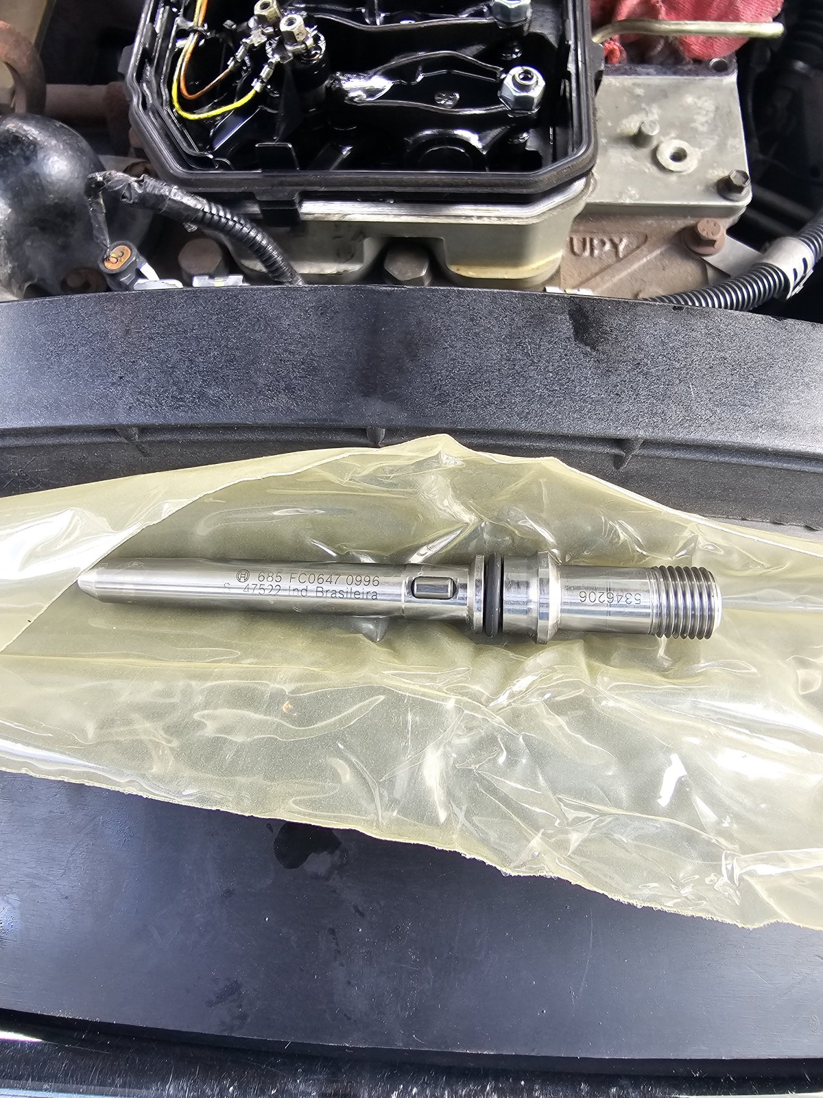

Just want to say thank for al the help on this. I replaced #2 injector today. Came all apart in about 30 minutes. Took time cleaning and going over all torques. Was actually pretty easy. Only snafu was Genos sent me the wrong feeder tube. It was a little larger diameter than what I had in mine and did not have the 2 check balls to place it, had a different positioning area so I cleaned and reused my feeder tube. Runs great so far. Here is the part they sent for my 06.
Yes, you are right, Geno's said they replaced those like 10 years ago so it is not really new to them, just new to me. They let me return it for now. If I have any more injector issues, I will probably change the rest of them and then all 6 of these tubes.
