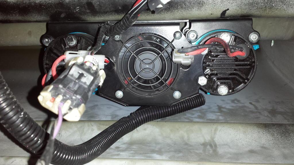

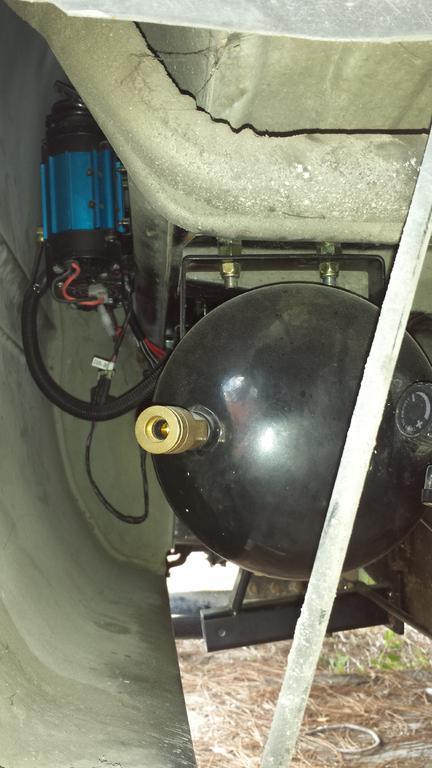

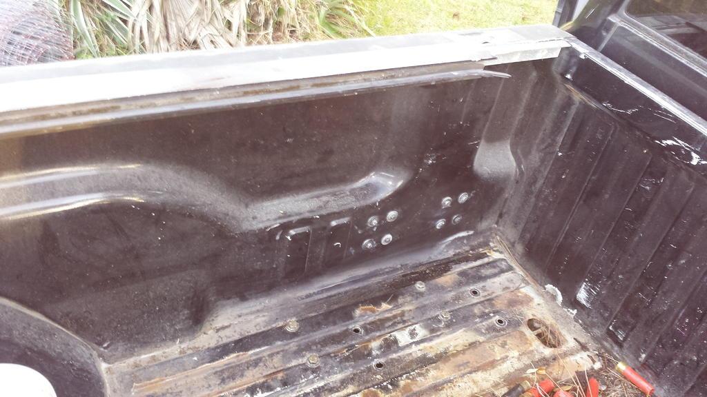

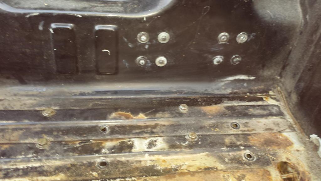

First off, I had trouble finding a suitable location to mount the compressor. Our trucks really don't have many places to put it. Due to the dual batteries, brake system, air box, and turbo, I could find no room under the hood. I decided to install the compressor in the cavity between the bed and the bed exterior skin, mounted against the bed interior. I bolted the tank to the bottom of the bed. As you can see from the four extra holes, I had to move the tank because it interfered with the Torklift camper mounts I installed a couple weeks later. I recently removed my bed liner and discovered the only rust on my truck. That has been added to my list.

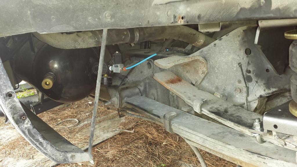

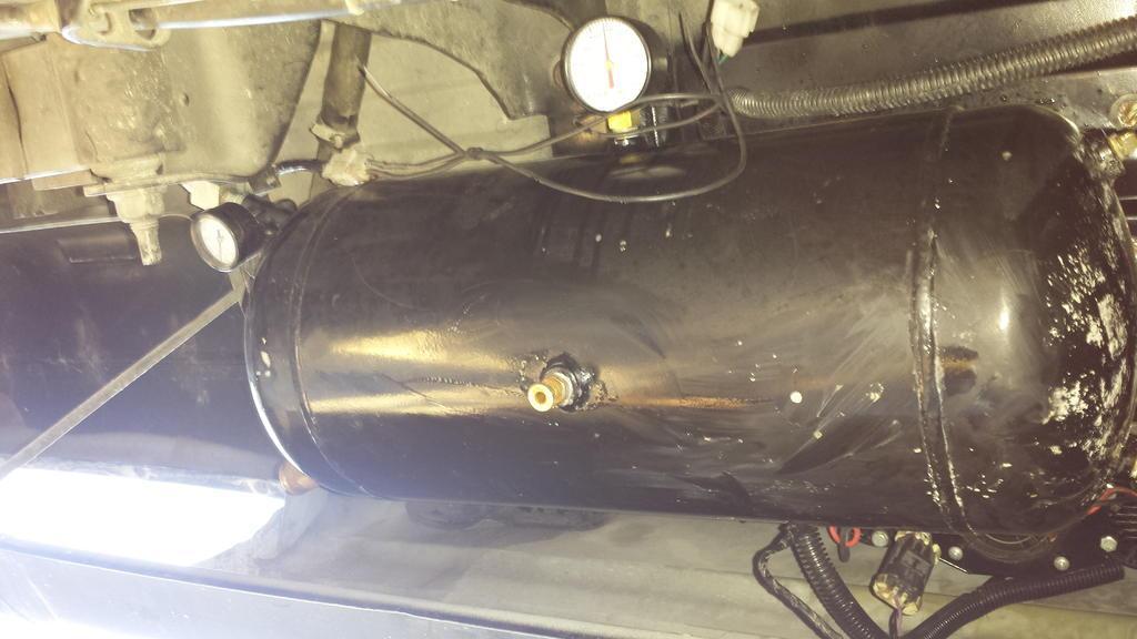

These are pictures from below. As you can see, the compressor is well protected from the elements. I live on a dirt road and is still very clean, even after approximately two months and a few hunting trips. The compressor is water "resistant" and may be briefly submerged. I hope not to test this. The air is taken from above. The filters on top may be extended even higher like snorkels. The harness and fittings are extremely well made and are water resistant.

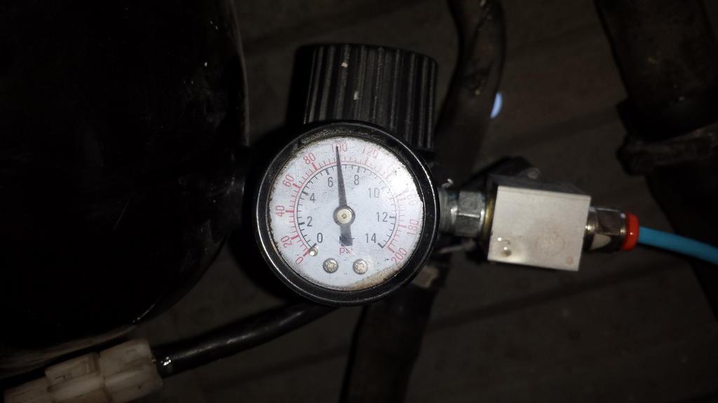

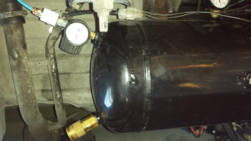

My rear ARB locker is limited to 100 psi, so I purchased a small regulator from Home Depot. I then mounted the ARB pressure switch to it. I installed a 3/8 air hose coupling so I could air up the tires on my truck or dirt bikes. I went with 3/8, to increase the flow, should I have to seat a bead. I plan to install a regulated coupling so I may run air tools. I used push in quick connectors between the compressor and tank. I used pipe tape (Teflon tape) on everything. After two weeks, I am holding 150lbs without losing even a pound. Though well protected, I wrapped everything in wire loom for extra protection. I did have to extend the two wires going to the solenoid for the locker (not yet wrapped). I soldered the connection and used shrink wrap. I am extremely happy with the outcome. I plan to install cab controls for the airbags in the future. As of now, I have the schrader valves in place of the license plate bolts.

I don't know if you can tell from the pictures, but it is mounted in the cavity between the interior of the bed and the outer bed skin.
With the wheel well reinstalled, it is well protected. After a month of dirt roads and hunting trips, the compressor is still clean. If I find it starts getting too dirty, I will take Mlee's advise and build fabricate some sort of skid plate. The ARB also has hard water resistant filters, so they will not get ruined if submerged (which means I probably have bigger problems) LOL. Thanks again

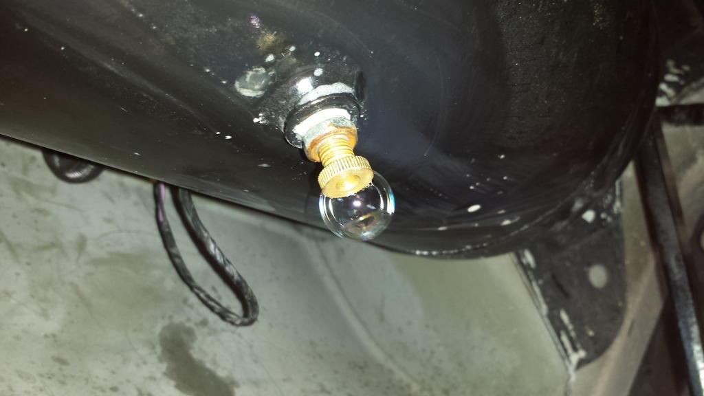

Do you have a drain valve on the bottom to get rid of moisture that develops in the tank? The ORT trucks have a spring loaded valve with a lanyard for dumping the water build up. Something to consider. Looked at the pic #3 from the bottom, looks like a drain of some sort. your covered.
I do have a drain valve. After the initial install, I had a slow leak. Using soap and water in a spray bottle, I found it. I was extremely pleased the location of the leak was the drain valve. I just twisted it back and forth a couple times and it stopped.
Here is a better photo of the compressor location. The ARB compressor is the only on I could find that would mount in that cavity. I'm sure there are others though. Thank you agian
