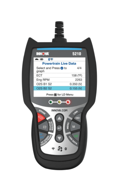

I had a scan tool (not alphaobd) from the parts store (below) that did codes, live data, etc... once it set the "hard code" I was unable to clear it, unable to do anything and the truck would not take more than a small input from the throttle before cutting power... Not good on I90 with a 16k 44' 5er behind you... took a long time to crawl up the hills... But after I dumped the trailer, putting around town was not a problem empty. Not saying this is an issue for you, but I think Im going to spring for the Alpha OBD so that I have more capability. Not sure if it would've helped in that situation, but the off the shelf scan tool did not.
