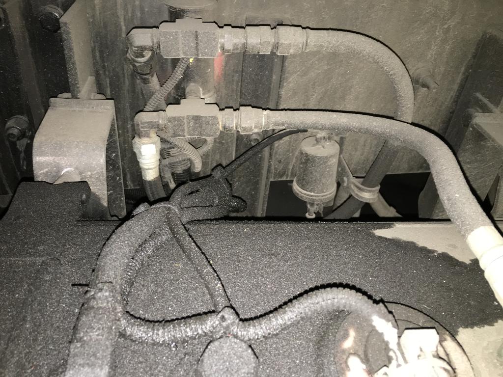

Now you have me even more curious. I have always assumed there was some kind of filter in a vent if nothing else to keep bugs out. I've also wondered about a check valve to prevent fuel spillage. It is one place I've never explored on my truck. Just to hard to explore without a reason to do it.

The simplest thing to do is cap the vents on the tank and install a vented fuel cap. The stock fuel cap can be modified to vent by removing a spring.You don't need the tankkit, that can be done with very cheep fuel filter from lawnmower or something, and a little 3/8 Fuelhose.
