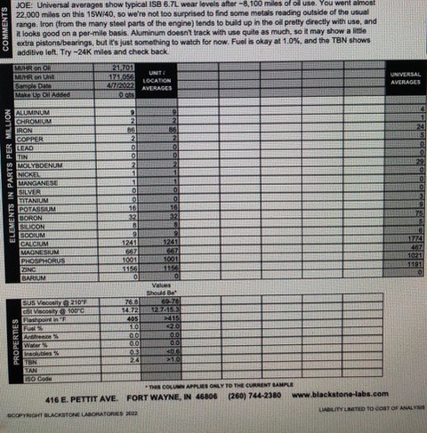

This generation truck does an active regen at least every 24 engine run hours, more in certain uses. Fuel dilution is not an issue on this generation of trucks. I had around 19 regens on my last oil change and the oil level never changed. You have something else going on for all the fuel dilution. Do you cold idle a lot?
The dominator has sheared down almost to a 30wt, that’s not good. It’s lost nearly 6 cSt from new, Cummins states the max you should see before changing to oil is 5.
It’s been mentioned before, but I would try a different oil. Use a 15w-40 designed for all the emissions stuff and see how it does.

IMHO you should go back to AMZ/OIL Signature series 15-40 with either AMZ/OIL or Donaldson filter. My friend 13 went 22k and Blackstone suggested 24k next time. I think you are doing a lot of hopping around for no reason. He does not have a bi-pass filter.

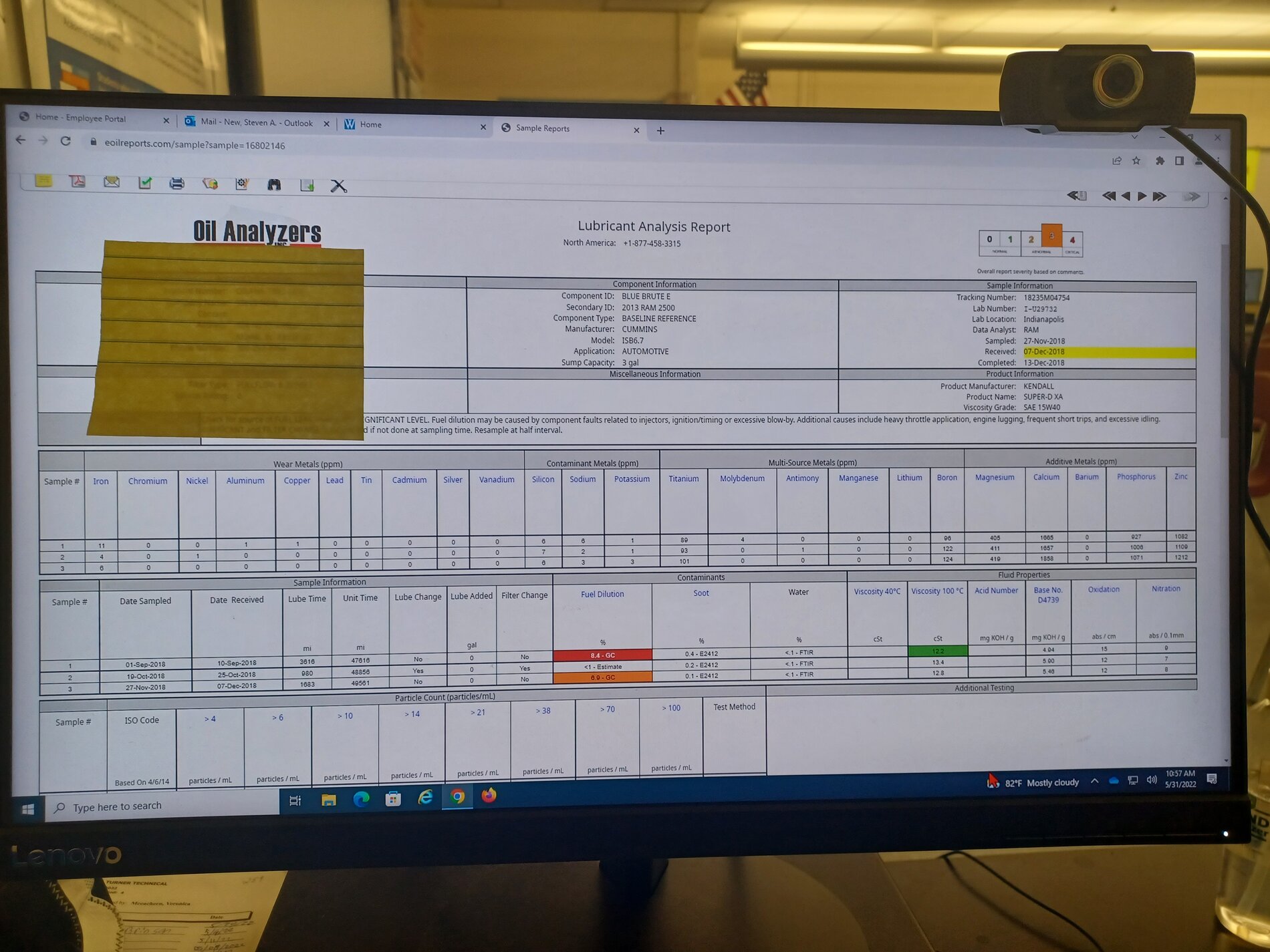

@Newsa what oil was the baseline reference in line #6?
Which test was the signature series?
Sample 7 and 8 likely don't have fuel/soot data because they thought it was a baseline.
6 and 7 appear to be the same oil, but 8 is different.

The #6 was a baseline on redline 15w 40 diesel oil. I discovered in some research online that Redline often gives false positives for oxidation. So, I wanted to see what an unused baseline sample would give as a result after getting an unsettling report after a 8000+ mile trip.
I am posting my results for #2 and #3 here which says Kendall super D, but they didn't change it to amsoil.when I filled it out on the paper. Since I didn't take time to edit the equipment, I guess they didn't change it to amsoil. Pretty sure this is signature series, but can't be 100% sure if it is signature series. I know it is amsoil.
You will notice that #2 and #3 are on the same sump of oil with #2 being less than 1000 miles on the oil, and #3 with another 700 miles.

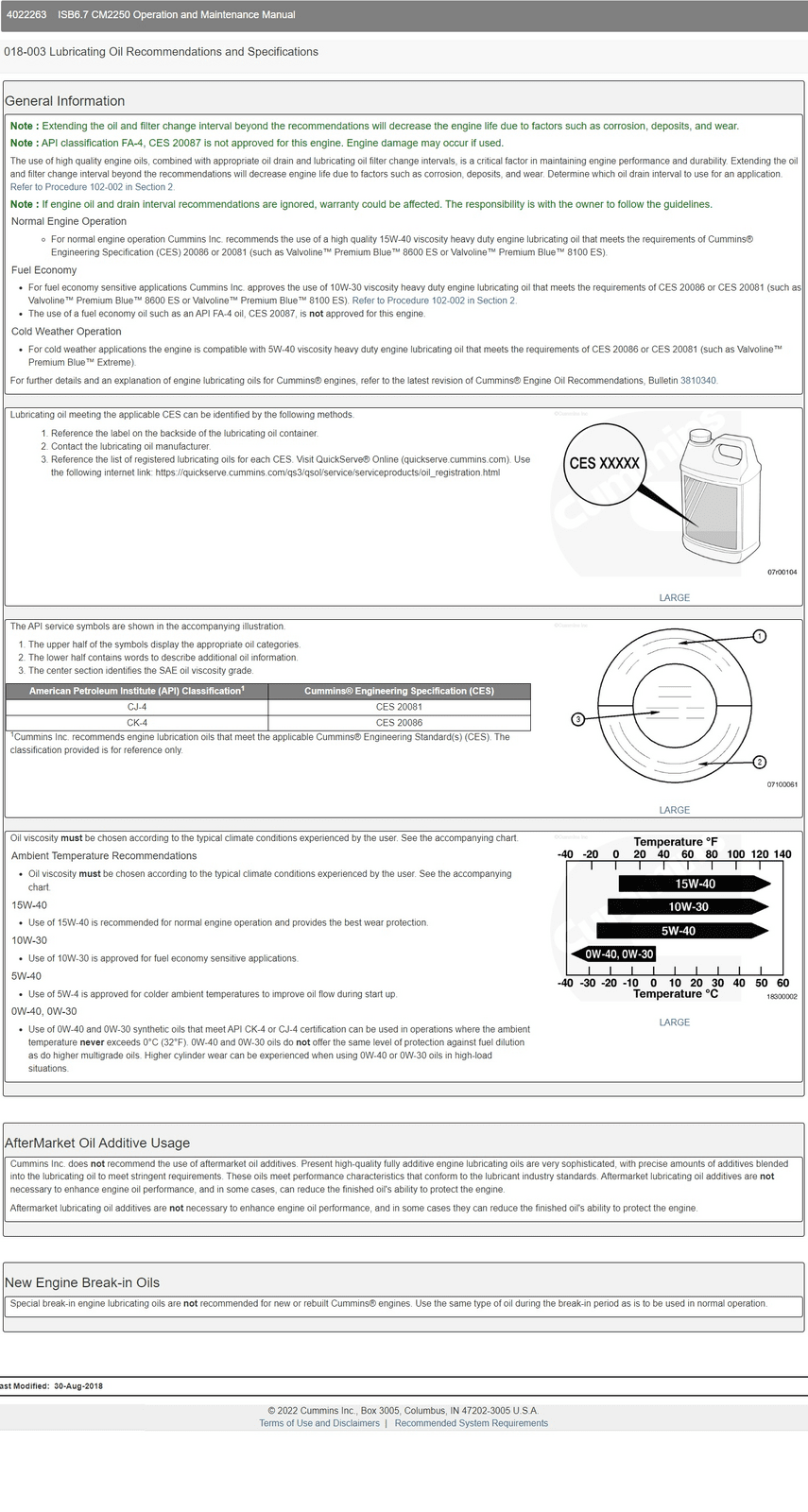

From BigPapa's post above. "Use of 15-40 is recommended for normal engine operation and provides the best wear protection". Shows from 0 degrees F on up. But using Full Synthetic gives you protection down much lower. So why in the world use anything else???
