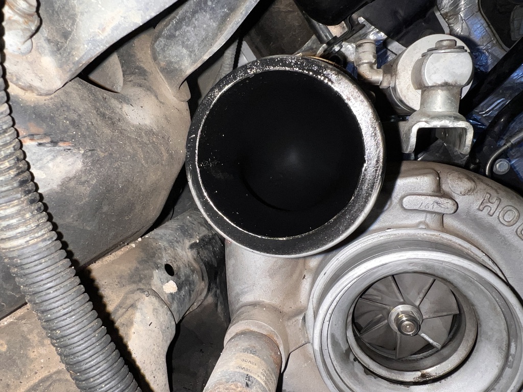

I see oil in front of the compressor in that pic. If the tube you just took off is dry than turbo time.
inlet Tube to turbo charger is bone dry. Help me understand @Tuesdak - if there is no shaft play front to back then what could be making the turbo leak?

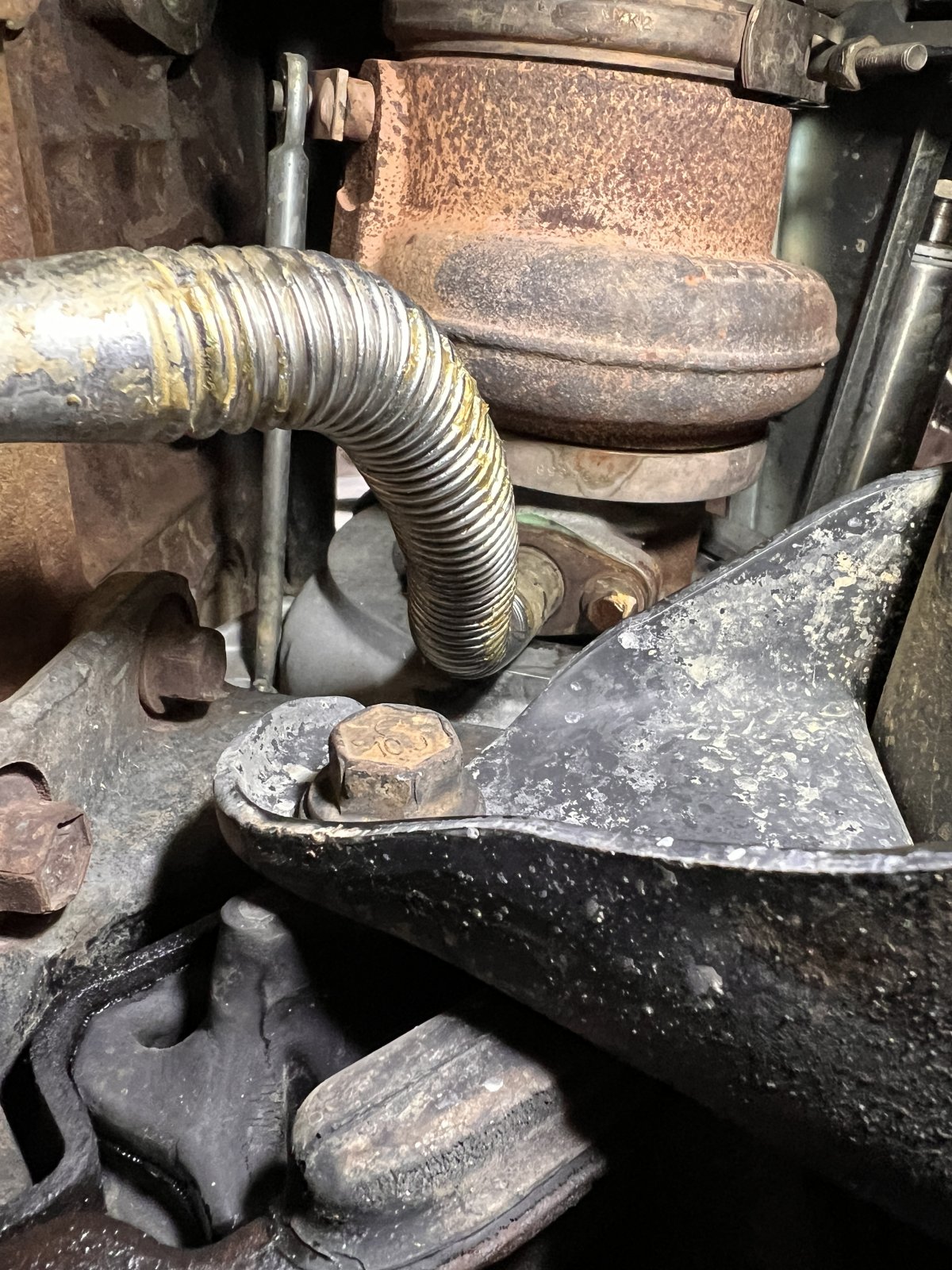

Here is a better pic of the drain. looks fine to me as in there are no horizontal sections. its all downhill.
