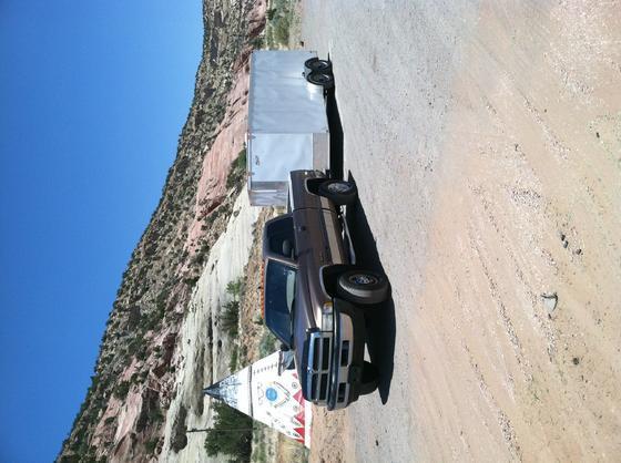

This is the truck/trailer combination in question.

Over the years I take pics of each truck I have driven while going by this spot. NM/AZ state line on I-40 next to the Speedy's fuel stop (Lupton exit).
