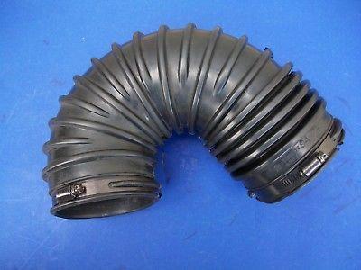

Does Anybody have a source for JUST the hose clamps on both ends of this OEM intake hose? NEW would be best. NO LUCK!!!!!!!!!
If nothing else I imagine you could make your own easy enough. Buy a standard hose clamp of the proper size and cut the slots where the tabs of the hose protrude through with a Dremel tool.
It would be easy work with a small cut off wheel on a Dremel. And clean the ends up with a tapered stone on the same dremel... Or you could simply get rid of the rubber tabs on the boot and use a standard clamp...they are simply locater tabs for the clamp and really don't serve a purpose once tight.
Neither would be my first choice but if parts are indeed discontinued sometimes a little creativity is in order.
I've tried several sources, but no joy. The only thing I have not tried is calling the dealer with the part number and having them put the number on the locator.
Maybe some dealer has old stock.
