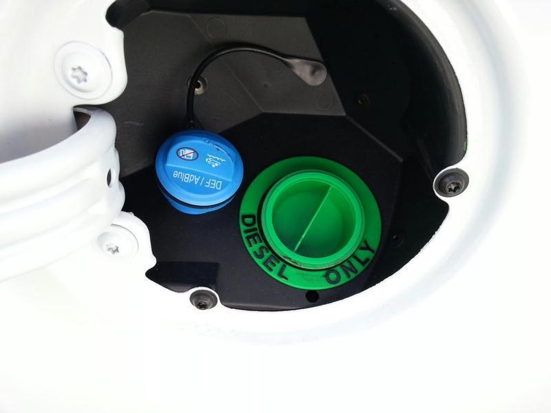

This was posted on CF... It was shipped with the plug, on a 14MY.
Not only is dirt a concern here, but when I went to fill up after running it through the car wash... there was WATER on the flap! Crabjoe, I like that green plug that came with yours, maybe i'll run over to the dealer and see if maybe they have a discarded one, otherwise i'll give the rubber sewer cap or Joe's ABS idea a shot.

There are two separate valves . When the top one is opened the cavity to the next one is vented. Any liquid that gets in here will run out a drain line to the ground. Not an issue at all according to my son. We were talking about it while adding DEF yesterday. (used 19L or 5 USG to go 8700 miles) received warning 200 miles to go before limited to 5mph. Ran it that low on purpose to make sure all warnings working.
The Genos one works great. It does on my 13 anyway. 14's have some type of plug now, or so I have read on here.
Only issue I've had is that the green plastic that sticks about an 1" above the top cap snapped on me the other day. A chunk came right off when I pulled out the fuel nozzle!!!! Truck only has 2000 miles and when I took it to my dealer they told me that for $700 they could replace it but not on warranty? I'm throughly UNIMPRESSED!!!!
