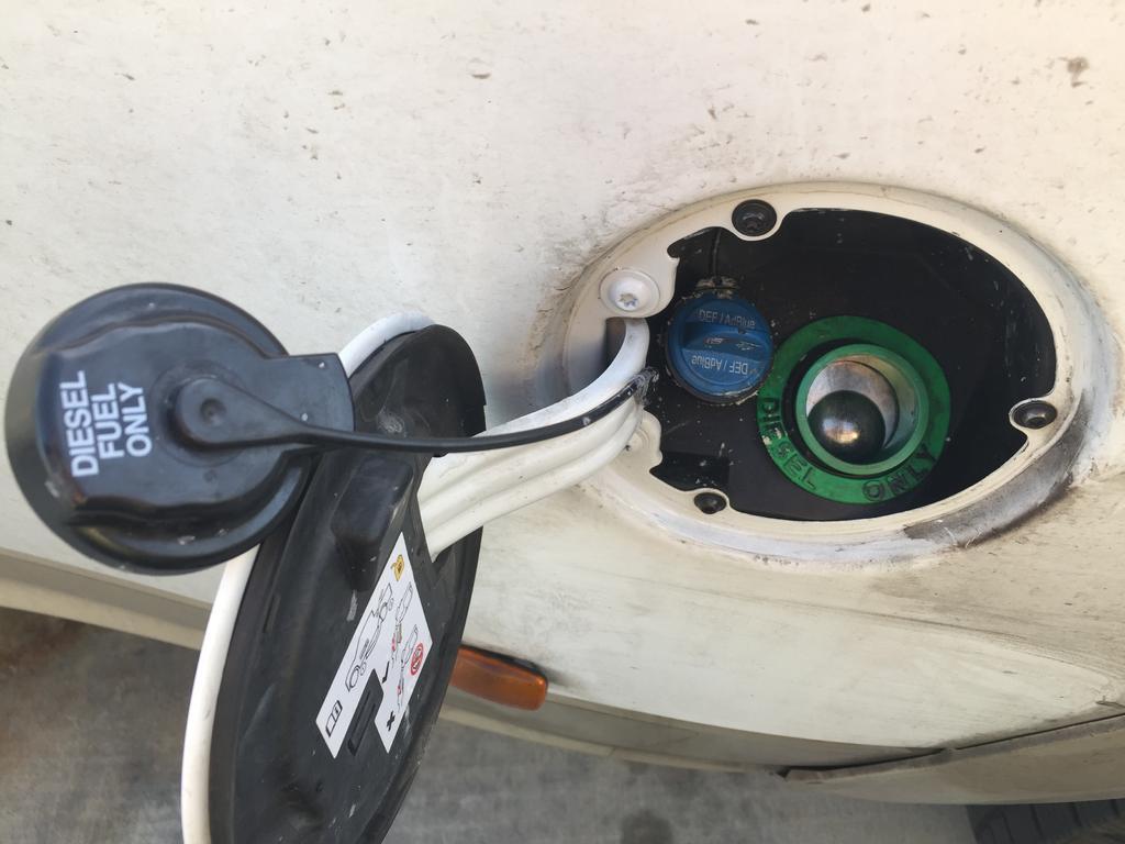

The question has not been answered, How to you abuse a cap less fill spout. I think if you start ramming the nozzle into the cap less spout your going to get someone's attention, although many hate the cap less fill spout on the 2500/3500 Rams, ramming the nozzle to fill to the point of breaking the neck Hmmmmm, Components on any vehicle need to survive the environment that they live in, that's not consider wear part, the cap less spout certainly would qualified for a NONE wear part.
The $1.50 fix...
Only issue I've had is that the green plastic that sticks about an 1" above the top cap snapped on me the other day. A chunk came right off when I pulled out the fuel nozzle!!!! Truck only has 2000 miles and when I took it to my dealer they told me that for $700 they could replace it but not on warranty? I'm throughly UNIMPRESSED!!!!

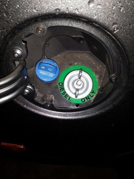

I believe Geno’s Garage sells a rubber plug for the cap less trucks now. Sorry...Didn’t read ALL the posts....Sound like everyone knows about the plug from Geno’s....Although I like that other plug from the plumbers shop...Looks great.

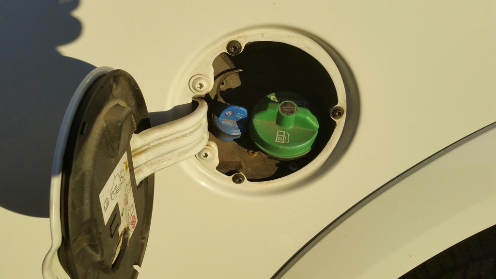

I went roughly 10k miles last summer with my 2013 though western Canada and Alaska. Up the Alcan, up through Chicken down through South Central Ak. And back via the Cassiar Highway. No issues with the filler cap or lack of. Burned about 2.5 gal of DEF every 1500 miles, hauling a Cabover (~12.5k).Every time I got fuel checking to see how dirty the filler area was was. For the most part it was clean. However I did add a test cap after I got back just to be safe. I have roughly 20k miles and don't see any difference in the filter after the Ak trip and driving the west coast, changed filter at 10k and 20k... Just call me old school :)

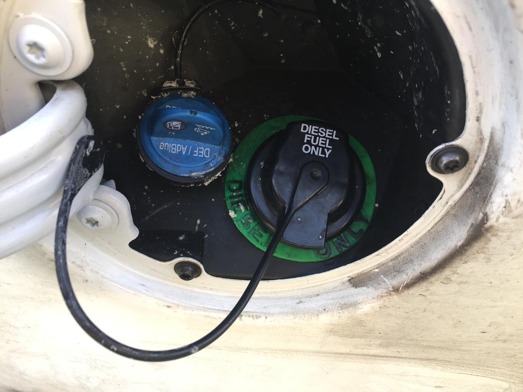

Bought the Aluminum plug. Installed a locking fuel door and caulked around between the door and the fender to keep the water out.

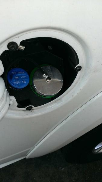

2001 filler from: http://www.fillernecksupply.com/search.php?search_query=Dodge+Ram 2500+2001&Search=&section=product
For mating fuel filler pipe, had to have a coupler from oem 2014 to 2001 filler hose too. it's tight. Trimmed hole in 2014 filler base up and to the right and kept it small enough to have to force the filler lip into it and pop riveted it in. Spaced the filler housing inward near half an inch to allow clearance of the larger cap. Originally I just wanted to move the frak'n def filler somewhere else. But this works pretty good. I can fill it to the top and not spill a drop... I'll see if I can get a pic with the cap off... honestly, this is an awesome mod, so glad it is DONE! ...Nice if someone could just kit this completely out, because it would SELL... NO MORE MESS!
