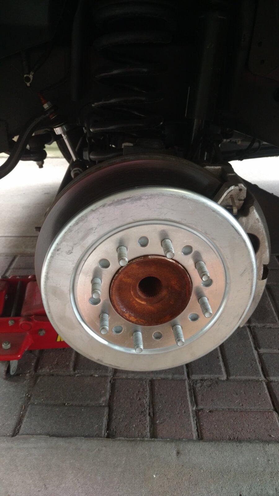

I received my Centramatics yesterday evening. 2 were flat not counting the ring and 2 had a slight offset and also came with I'm wanting to say 2 1/8" spacers. I did a text fit on the front and this is what I came up with. Had to use the spacers and offset ones. The back will not be a problem ring will also be in the inside. I'm not going to install them till I get my Road Force balancing on Monday. Will try to get them on that following weekend when we get back from camping. Trying out our new 5th wheel.
I received my Centramatics yesterday evening. 2 were flat not counting the ring and 2 had a slight offset and also came with I'm wanting to say 2 1/8" spacers. I did a text fit on the front and this is what I came up with. Had to use the spacers and offset ones. The back will not be a problem ring will also be in the inside. I'm not going to install them till I get my Road Force balancing on Monday. Will try to get them on that following weekend when we get back from camping. Trying out our new 5th wheel. View attachment 123544
on my 2018 2500 i used the offset ones on the front without spacers. there was a 1/4 inch clearance between the balancer and the caliper...cheers comrade! :)
Got my road force balance and they had to rotate one tire to match the wheel or wheel to match the tire. Right front was slapping the pavement. I still have a little little vibration nothing like it was. This is when I'm not towing the 5th wheel. When towing very smooth. I don't know if this is the nature of a long bed i.e. no weight in the back. I hope to find some time this weekend to install the Centramatics.
Installed the Centramatics yesterday morning. Couldn't believe the amount of brake dust inside the front wheels. All cleaned now. Anywho took it out on the interstate late afternoon and all is good. The only thing that I experience when hitting a raised expansion joint is an after shock that runs from front to back. I guess I'm to picky on on ride and comfort.

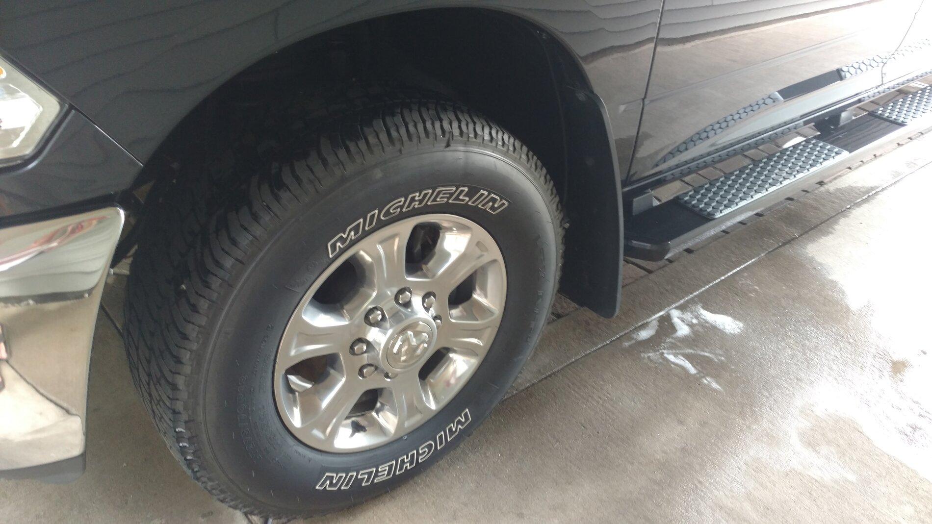

I skeptically bought a set of 300-318 for a brand new set of cooper at3s. I have just a short ride with them so far and seat of my pants feel says they are doing their job. I will get back to you after I have a long road trip and hauled the trailer for a while.

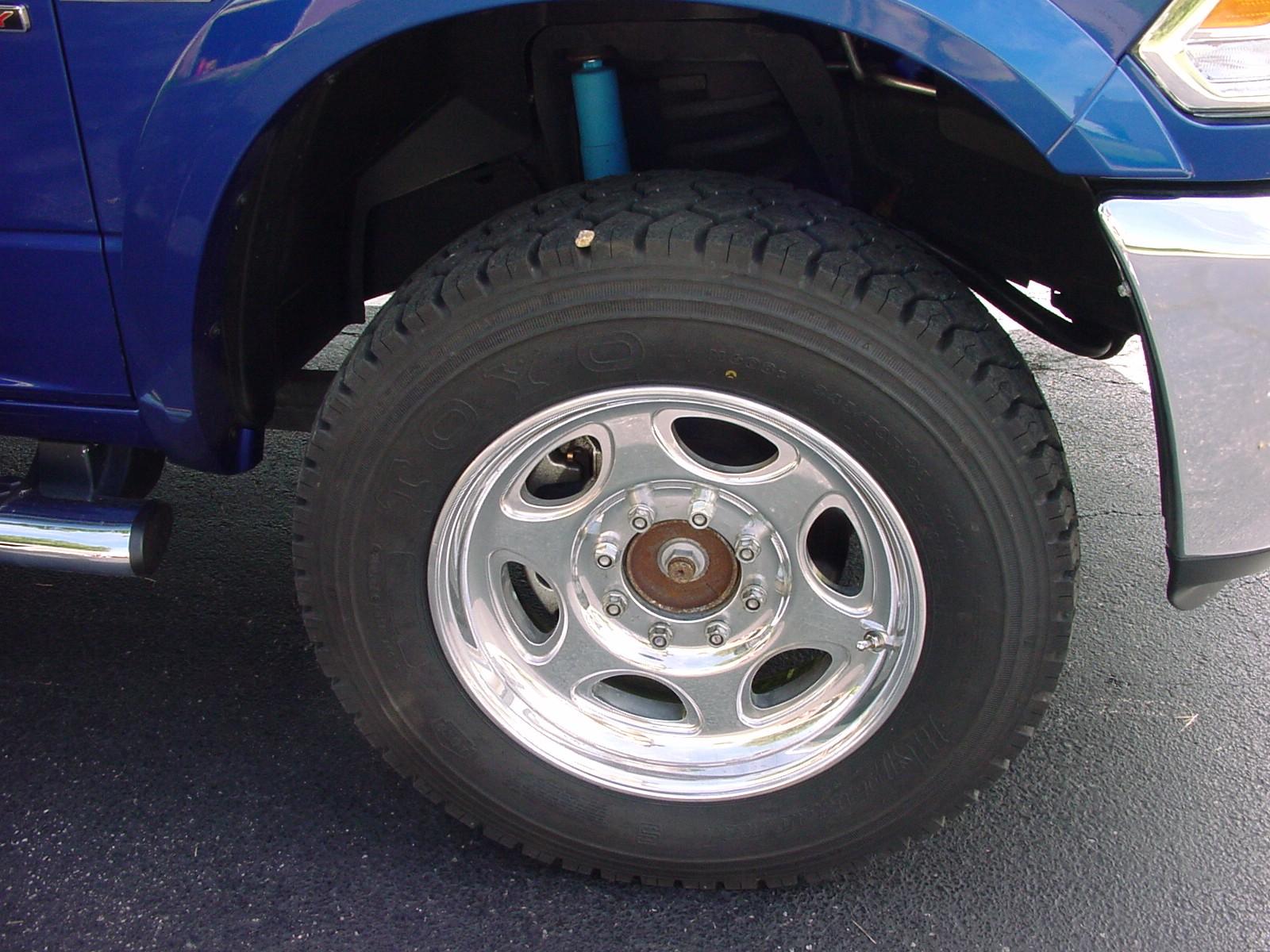

another thumbs up for my centramatics - comrades - i installed a second set of studded wheels and tires for winter. last winter they had a decent bounce to them. ( i had them balanced 2x and still not right ) now, with the balancers and a known set of out of balance wheels/tires, the truck is still glass smooth. i love these things. just sharing.....cheers!
