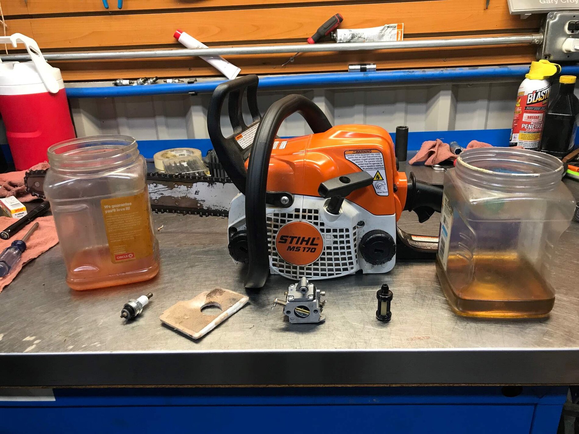

First up from the small end of the Stihl offerings an MS170. No start condition, operator error. Duh.
We at least take a look at the fuel tank but this one needed draining and rinsing. The fuel is supposed to go into the tank on the right and bar oil goes in the tank on the left. the gas tank was full of bar(?) oil and it had some "mix" of something in the oil tank. This saw we just carb it not kit it so carb, filters and plug and it was released back to its owner.

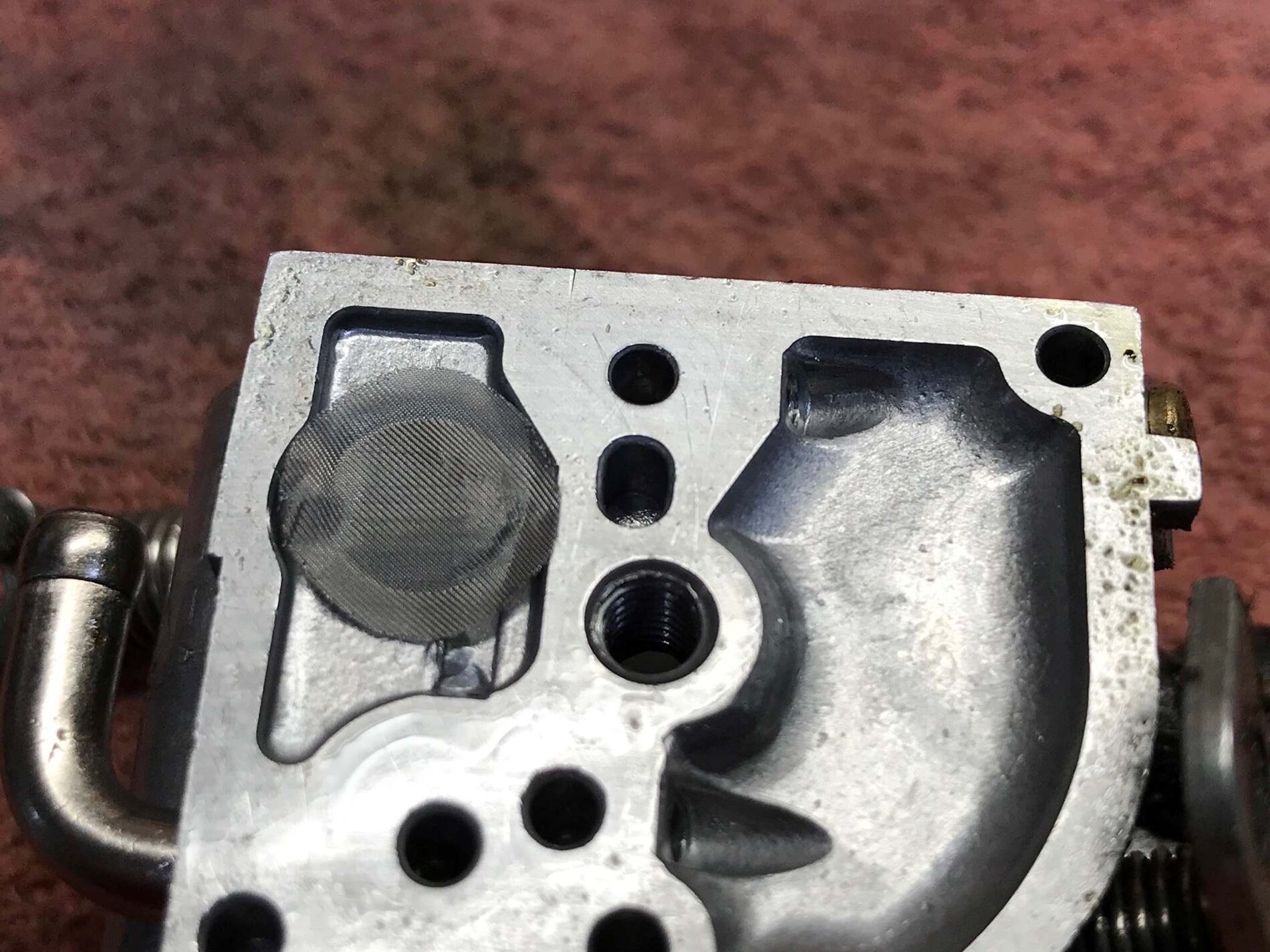

And every so often we have to clean up after a DIY repair goes awry. that small screen is about the same size when installed as a pencil eraser when its CORRECTLY pressed into the carb no just laid on top of the fuel pump surface. This also damaged the pump diaphragm.

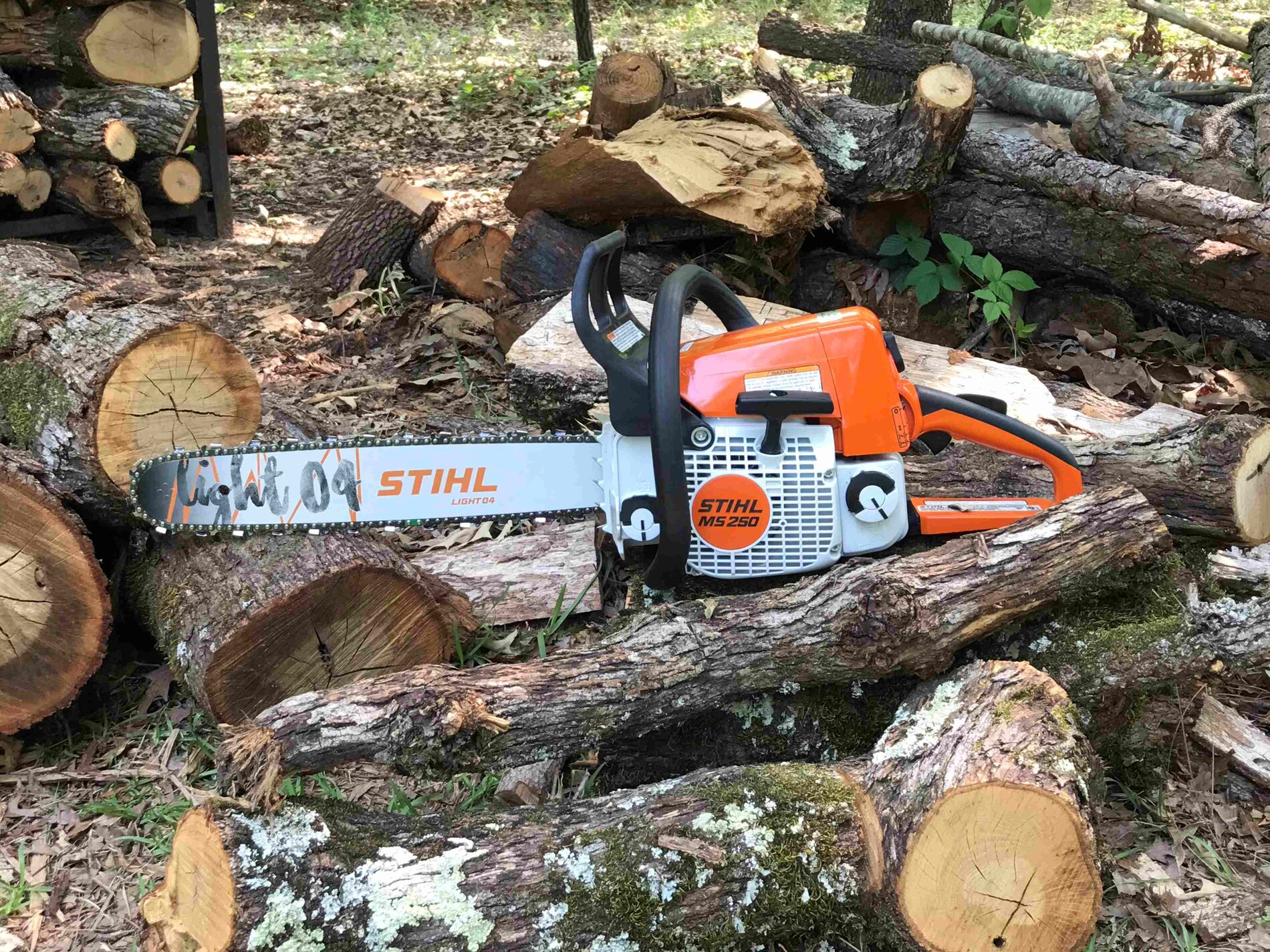

And finally from the does he ever take his own advice? This fresh MS250 winked at me from the showroom and I adopted it. It just arrived with a build date of this month. Real nice size for smaller tasks that don't need a heavy saw.

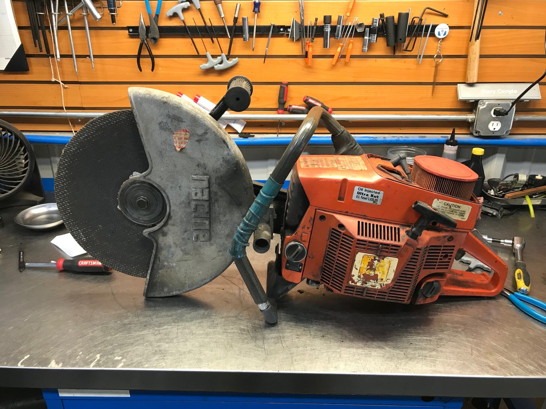

Next a nice What Is It pic. So name the tool and no a "chop saw" is not enough detail info. What is it made to do?
It had a fuel leak, carb issues and a no sparky thingy. SOMEHOW I got it running just needs a QC check run. Cover over air filter had been removed just prior to pic snap. Yeah it's big and heavy.

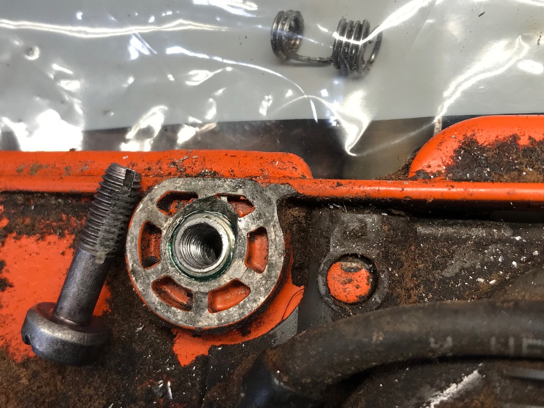

A commercial account turned this one in for fix it with no details just fix. And the chain brake handle was broken as a visible details.

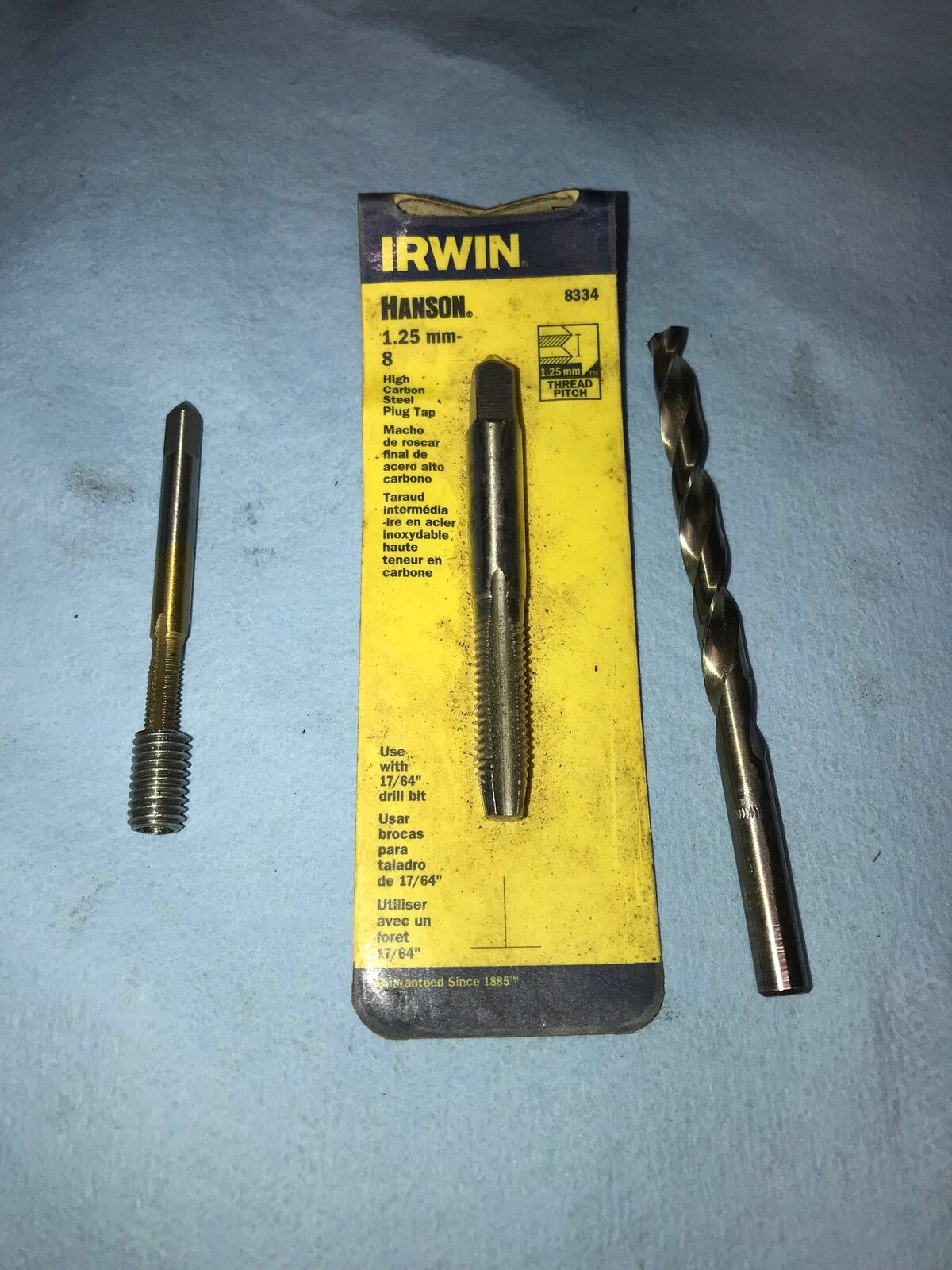

Basic insp and a test run test, yup it's a survivor. Chain brake handle time. This is possibly the easiest handle repair you'll find. Anchors under the top front recoil screw and slides onto the brake lever. Easy oops but not peasy. The screw hole was badly worn out and previously spring type insert repair. Boss suggested going to M6 to replace the M5 but that had its own issues going thru a hard steel bushing. Time to ponder.
What about a M8 to M5 steel bushing insert? Take an M8 bolt and drill and tap to M5?
I like a challenge so at HOME using only a good old drill press and some get 'er done I setup an M8 to be the donor for this bushing. sThe pic shows the bushing and the new M8 tap and drill.
Finally got the go ahead. Careful drilling to get to tap drill, then M8 tap and badda boom we have a tapped hole for a bushing. Cleaning, then sleeve lock, cure overnight then assemble and its an invoiceable repair.
Later on I found out that this same off the shelf M8-M5 bushing exists but we only needed one not an economy pack so it was an interesting DIY repair to save a running saw.
Of course, pics or it didn't happen. DIY bushing and then the failed insert, new screw and new bushing installed.
