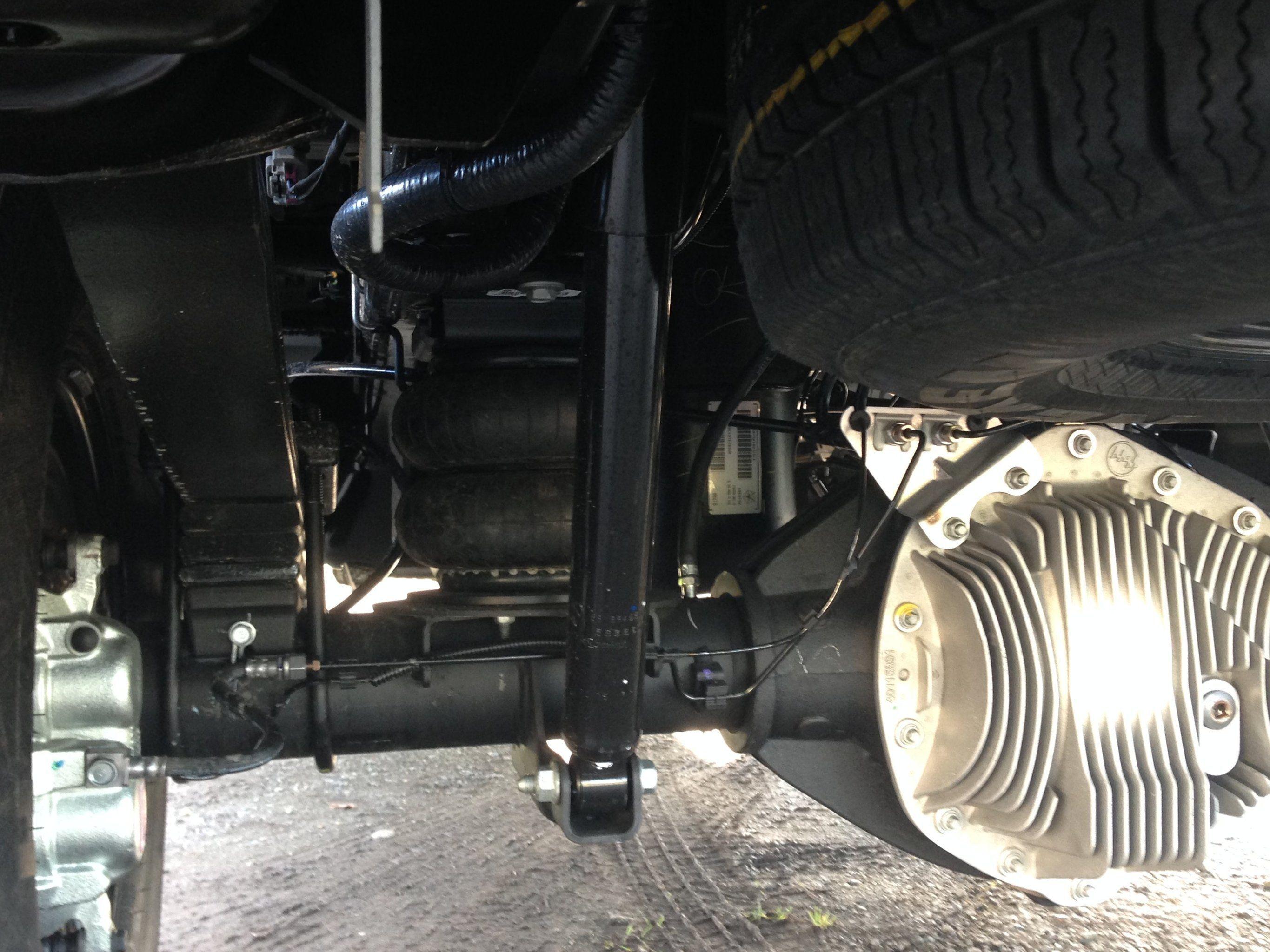

Greg, have ya replaced either of your diff covers with a "finned type" yet? Just wondered? Olde Bob
My rear differential does not have a cover. It is part of the axle assembly. The entire carrier assembly is bolted in from the front part of the axle.
The front does have a cover, but I’ve not even shopped around for one.
My 4500 front differential holds about 5.5 quarts; the rear holds about 7.5 quarts. I don’t see any need for additional capacity with what it already has.
If you tow a lot you may want to buy the OE cover. Greg's new truck is a different ANIMAL.
