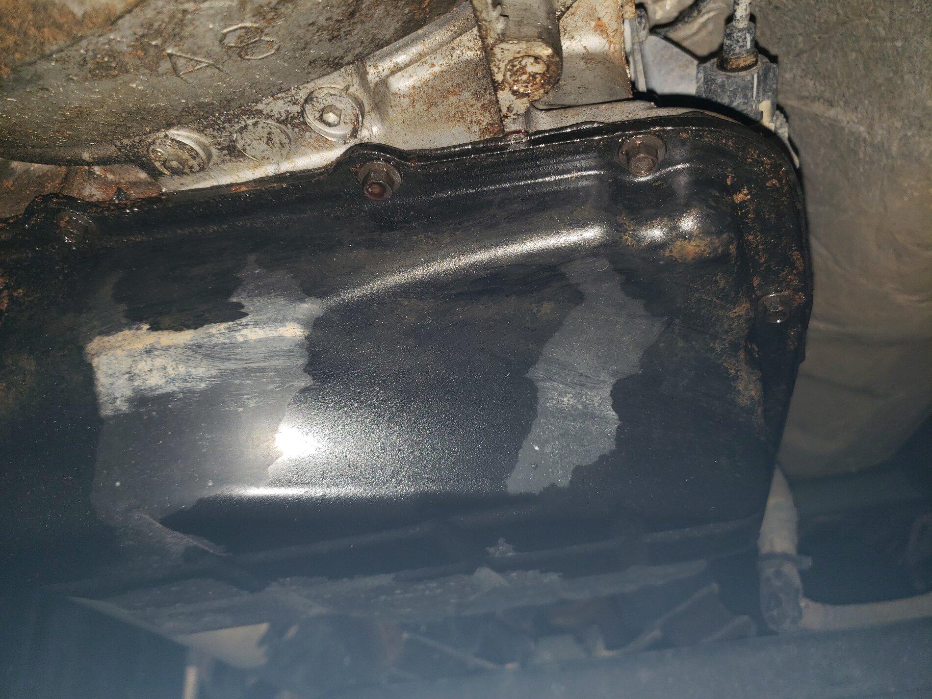

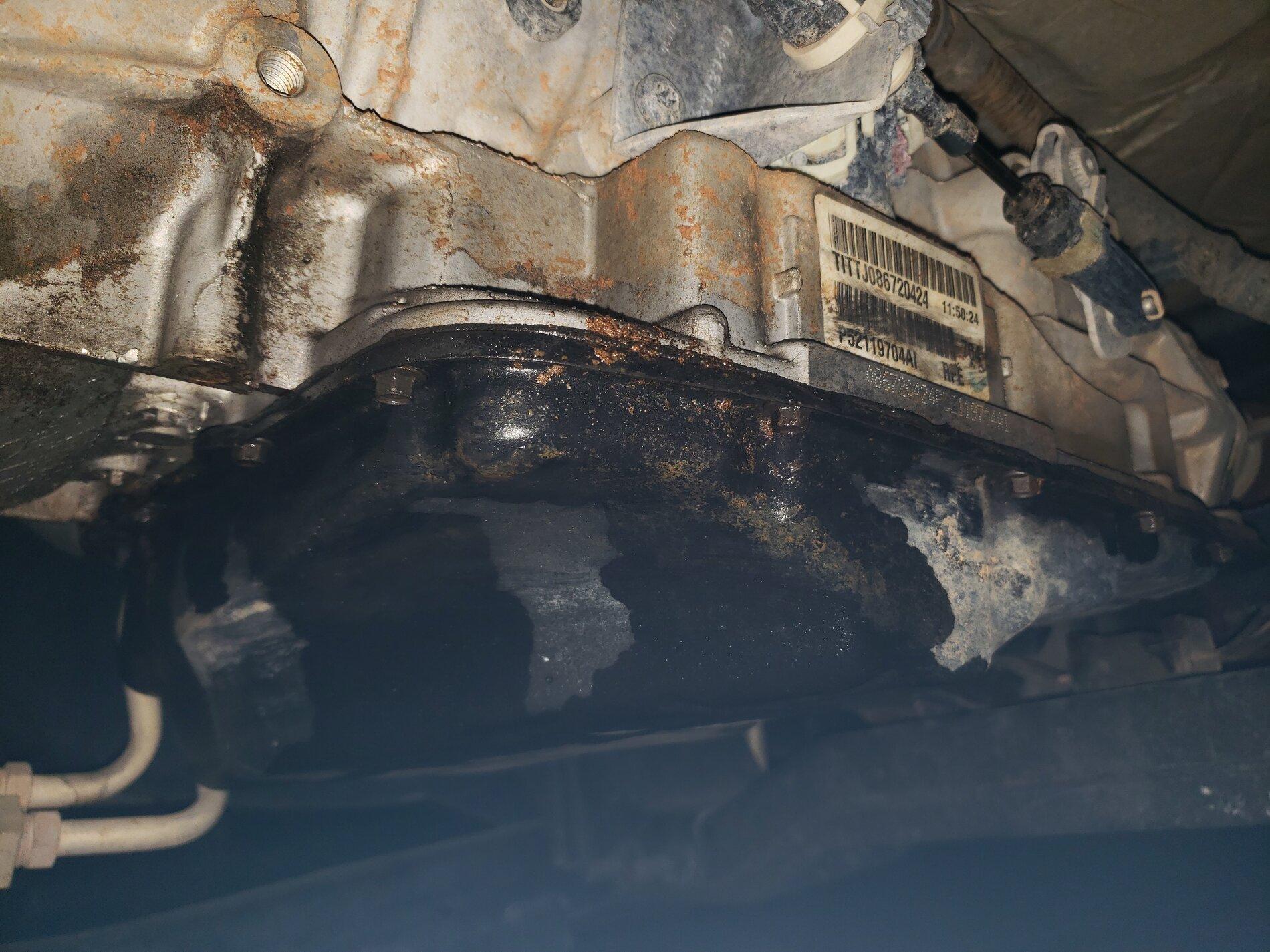

So I found a coat of oil around the transmission which looks to be leaking at the seal in a few spots (front and the side). Don't see a drip line anywhere., but it's definitely wet around it some, as you can see. So is this normal for the 68rfe or no??
Truck is 2017 3500 6.7 srw long bed cc. With 64k miles. Stock.
My 2008 which uses a 68RFE has a 135K on the OD and the Mag-Hytec pan is dry on the outside! I do have my transmission serviced about every 60,000 miles so, this may help!
Thanks guys. I guess we'll just service it all since it's over 60k miles now, then see if it leaks after servicing.

Getting back to the OP's original question: No, I don't think the leak is normal. My pan bottom was 100% dry prior to service, and after a couple hundred miles since servicing, it's still dry.
