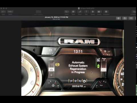

Do any of you ever get an EVIC notice of anything regarding Regen? Neither my 2009 nor my 2017 have ever provided a Regen related messag? When idling in park, the RPM increases a little over 1,000 and lasts several minutes. If it weren't for the RPM change and the CST2 monitor, I wouldn't know it was in regen. Just curious. Ron
Yes, on the '19+ one of the gauge screens on the EVIC is the DPF status. Normally it indicated percentage restriction. During a regen it indicates it is in progress.(Not my truck, just a google search photo).
