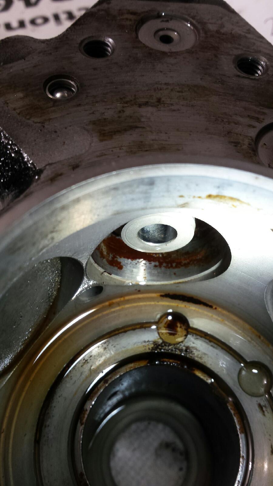

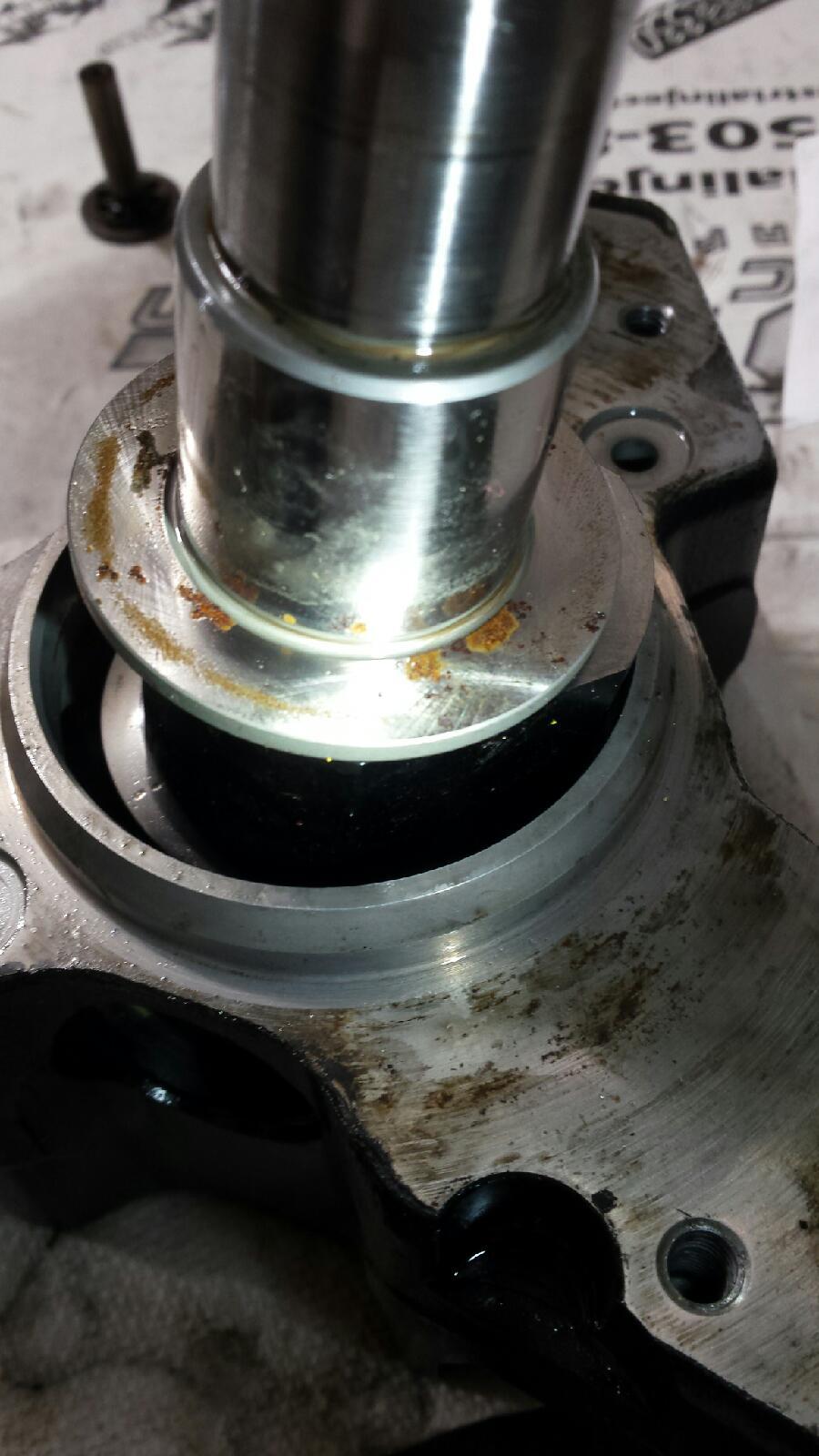

Its to late when that light comes on in most cases, it would require you not to shut the engine off and remove HPCR pump, first if signs of rust its $$$$ in repairs, if not do not start the engine and remove tank and inspect.

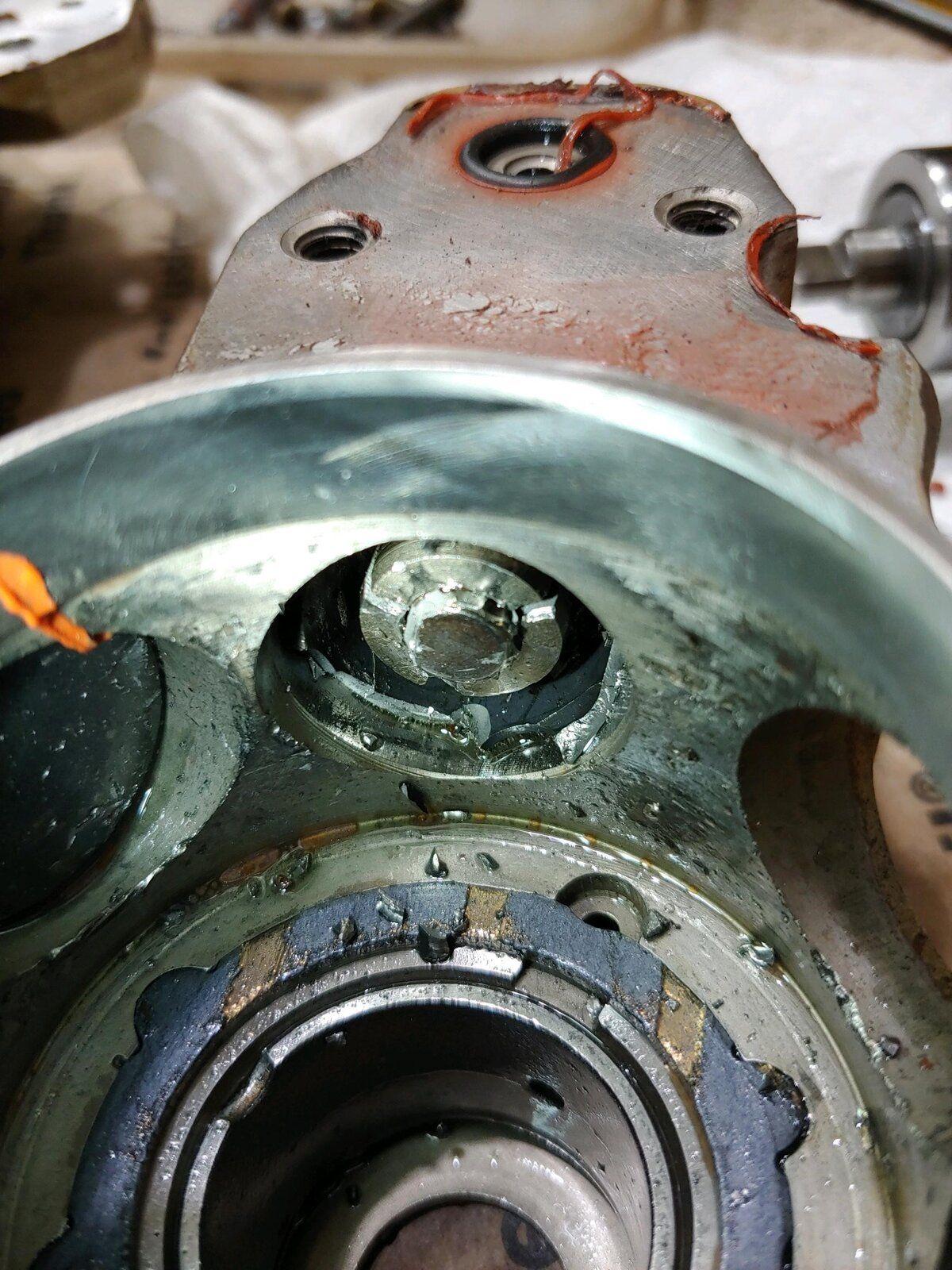

I need to clarify, the last Picture is a LBZ CP3, The Owner did NOT want to Pay TC for the adapter and mounting of the Gear $100.00, The owner DID NOT get the Gear tight enough and it jack hammered the Pump to Death in Seconds. I will post Pictures Later, I covered the Pump under warranty on the condition it was TC workmanship or part(s) failure. it was 100% the owner lack of failure to tighten the Gear correctly...Needless to say, The SOB renege, on his Promise, it was a Wild 11.2 at a cost of $1900.00.
I just wanted to show how destructive the CP3 can be and NOT destroy the Injectors unlike the CP4 Particle maker, the CP3 last about 3 seconds if it gets out of spec before its BOOM.
