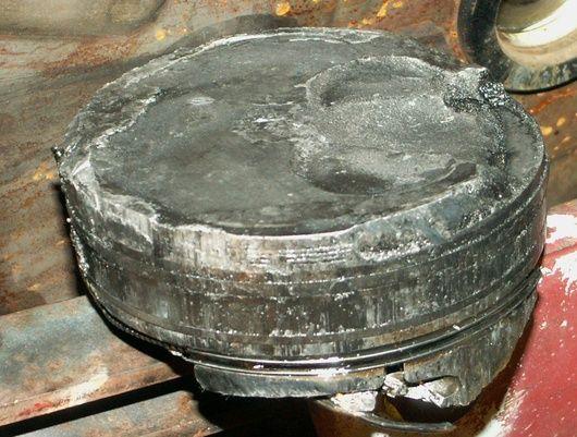

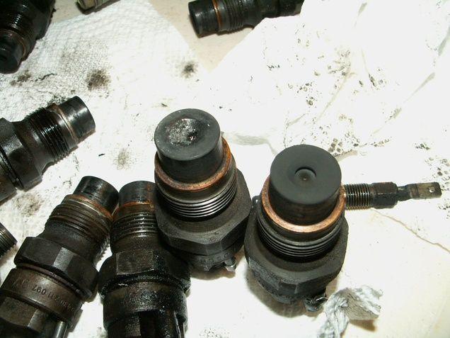

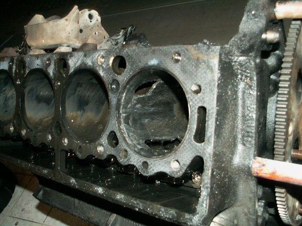

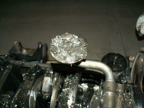

TC, the engine is going to fail anyway from bad fuel and at times without so much as even a WIF light as a warning. The only difference is 3 extra seconds of power for a $5K + repair bill with HPCR systems and if it also wipes the engine add $10-20K. Yeah I see stories of ignorance pushing their busted transmission or whatever broken vehicles along at a slow clip on the freeway posing a hazard to them and others all the time. I always recommend having AAA or the like and let the professionals hook it without endangering the driver and others.
I have seen IDI engines melt a piston from a bad injector with no warning other than a tapping when in the throttle. It did continue to run on 7 of 8 cylinders and the free wrist pin and rod knocked 4 holes in the cylinder. For example:
Yes, it took an hour with a 10# sledge hammer to get this melted aluminum plug out. Yes, "that" used to be a piston.

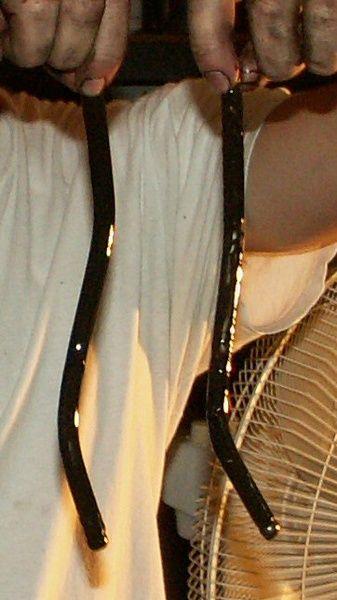

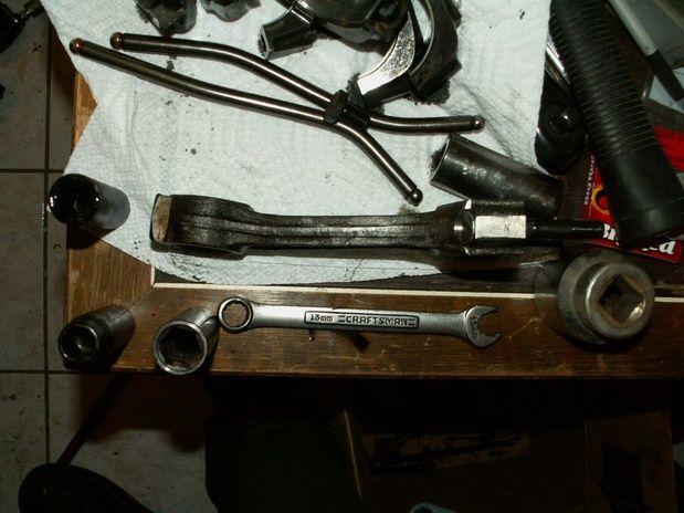

Yes. The rod is bent.
Regardless there is no reliable indicator what-so-ever that I know of that warns the operator you got bad fuel and power loss from fuel system (and engine) failure is seconds away. I get a hot light if I blow a hose and can make a decision to completely expend the engine and risk a vehicle fire in an emergency. Charging system failure light with expendable battery, "Low oil pressure stop engine" is a clear case of expending the engine for the time it takes to get pulled over and stopped, but It's a warning before failure. So I honestly fail to understand why the expensive engine and injection system is default expendable without ANY indication of a problem before the engine stops from bad fuel regardless of damage done to the engine and injection system.

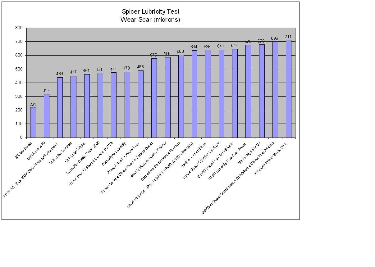

Here is the best recorded tests:
The following are the preliminary results of a research study on diesel fuel Lubricity Additives. There is likely to be further commentary and explanation added at a future time.
PURPOSE:
The purpose of this research was to determine the ability of multiple diesel fuel additives to replace the vital lubricity component in ULSD (Ultra Low Sulfer Diesel) fuel.
HISTORY:
ULSD fuel is the fuel currently mandated for use in all on road diesel engines. This fuel burns cleaner and is less polluting than it’s predecessor, called Low Sulfer Diesel Fuel. Low sulfer fuel contained less than 500 ppm of sulfer. ULSD contains 15 ppm or less.
As diesel fuel is further refined to remove the polluting sulfer, it is inadvertently stripped of its lubricating properties. This vital lubrication is a necessary component of the diesel fuel as it prevents wear in the fuel delivery system. Specifically, it lubricates pumps, high pressure pumps and injectors. Traditional Low sulfer diesel fuel typically contained enough lubricating ability to suffice the needs of these vital components. ULSD fuel, on the other hand, is considered to be very “dry” and incapable of lubricating vital fuel delivery components. As a result, these components are at risk of premature and even catastrophic failure when ULSD fuel is introduced to the system. As a result, all oil companies producing ULSD fuel must replace the lost lubricity with additives. All ULSD fuel purchased at retail fuel stations SHOULD be adequately treated with additives to replace this lost lubricity. The potential result of using inadequately treated fuel, as indicated above, can be catastrophic. There have been many documented cases of randomly tested samples of diesel fuel. These tests prove that often times the fuel we purchase is not adequately treated and may therefore contribute to accelerated wear of our fuel delivery systems. For this reason it may be prudent to use an after market diesel fuel additive to ENSURE adequate lubrication of the fuel delivery system. Additionally, many additives can offer added benefits such as cetane improver, and water separators or emulsifiers.
CONTENT:
In this study we will test multiple diesel fuel additives designed to replace lost lubricity. The primary component of this study is a side-by-side laboratory analysis of each additive’s ability to replace this vital lubricity. Additionally, claims of improving cetane, water separation or emulsification, bio-diesel compatibility and alcohol content will be noted. These notes were derived from information that was readily available to consumers (via the label and internet information) and none of this information has been evaluated for validity and/or performance. Cetane information has only been noted if the word “cetane” was used in the advertising information. The words “improves power” has not been translated to mean “improves cetane” in this evaluation. Information on alcohol content is provided by indicating “contains no alcohol”. Omission of the words “contains no alcohol” does not imply that it does contain alcohol. This information was simply missing in the information available to a consumer. However, the possibility of a form of alcohol in these products is possible. Additionally, information on dosages and cost per tankful are included for comparison purposes.
How Diesel Fuel Is Evaluated For Lubricating Ability:
Diesel fuel and other fluids are tested for lubricating ability using a device called a “High Frequency Reciprocating Rig” or HFRR. The HFRR is currently the Internationally accepted, standardized method to evaluate fluids for lubricating ability. It uses a ball bearing that reciprocates or moves back and forth on a metal surface at a very high frequency for a duration of 90 minutes. The machine does this while the ball bearing and metal surface are immersed in the test fluid (in this case, treated diesel fuel). At the end of the test the ball bearing is examined under a microscope and the “wear scar” on the ball bearing is measured in microns. The larger the wear scar, the poorer the lubricating ability of the fluid. Southwest Research runs every sample twice and averages the size of the wear scar.

THE RESULTS:
These results are listed in the order of performance in the HFRR test. The baseline fuel used in every test started at an HFRR score of 636. The score shown is the tested HFRR score of the baseline fuel/additive blend.
Also included is the wear scar improvement provided by the additive as well as other claimed benefits of the additive. Each additive is also categorized as a Multi-purpose additive, Multi-purpose + anti-gel, Lubricity only, non-conventional, or as an additive capable of treating both gasoline and diesel fuel.
As a convenience to the reader there is also information on price per treated tank of diesel fuel (using a 26 gallon tank), and dosage per 26 gallon tank provided as “ounces of additive per 26 gallon tank”.
In Order Of Performance:

CONCLUSIONS:
Products 1 through 4 were able to improve the unadditized fuel to an HFRR score of 460 or better. This meets the most strict requirements requested by the Engine Manufacturers Association.
Products 1 through 9 were able to improve the unadditized fuel to an HFRR score of 520 or better, meeting the U.S. diesel fuel requirements for maximum wear scar in a commercially available diesel fuel.
Products 16 through 19 were found to cause the fuel/additive blend to perform worse than the baseline fuel. The cause for this is speculative. This is not unprecedented in HFRR testing and can be caused by alcohol or other components in the additives. Further investigation into the possibilities behind these poor results will investigated.
Any additive testing within +/- 20 microns of the baseline fuel could be considered to have no significant change. The repeatability of this test allows for a +/- 20 micron variability to be considered insignificant.

BLIND STUDY:
In order to ensure a completely unbiased approach to the study, the following steps were taken:
Each additive tested was obtained independently via internet or over the counter purchases. The only exceptions were Opti-Lube XPD and the bio-diesel sample. The reason for this is because Opti-Lube XPD additive was considered “experimental” at the time of test enrollment and was not yet on the market. It was sent directly from Opti-Lube company. The bio-diesel sample was sponsored by Renewable Energy Group. One of their suppliers, E.H. Wolf and Sons in Slinger, Wisconsin supplied us with a sample of 100% soybean based bio-diesel. This sample was used to blend with the baseline fuel to create a 2% bio-diesel for testing.
Each additive was bottled separately in identical glass containers. The bottles were labeled only with a number. This number corresponded to the additive contained in the bottle. The order of numbering was done randomly by drawing names out of a hat. Only Spicer Research held the key to the additives in each bottle.
The additive samples were then sent in a box to An independent research firm. The only information given them was the ratio of fuel to be added to each additive sample. For example, bottle “A” needs to be mixed at a ratio of “480-1”. The ratio used for each additive was the “prescribed dosage” found on the bottle label for that product. Used motor oil and 2-cycle oil were tested at a rationally chosen ratio of 200:1.
The Research Laboratory mixed the proper ratio of each “bottled fluid” into a separate container containing the baseline fuel. The data, therefore, is meaningful because every additive is tested in the same way using the same fuel. A side-by-side comparison of the effectiveness of each additive is now obtainable.
THE RESULTS:
1) 2% REG SoyPower biodiesel
HFRR 221, 415 micron improvement.
50:1 ratio of baseline fuel to 100% biodiesel
66.56 oz. of 100% biodiesel per 26 gallons of diesel fuel
Price: market value
2)Opti-Lube XPD
cetane improver, demulsifier
HFRR 317, 319 micron improvement.
256:1 ratio
13 oz/tank
$4.35/tank
3)FPPF RV, Bus, SUV Diesel/Gas fuel treatment
Gas and Diesel
cetane improver, emulsifier
HFRR 439, 197 micron improvement
640:1 ratio
5.2 oz/tank
$2.60/tank
4)Opti-Lube Summer Blend
Multi-purpose
demulsifier
HFRR 447, 189 micron improvement
3000:1 ratio
1.11 oz/tank
$0.68/tank
5)Opti-Lube Winter Blend
Muti-purpose + anti-gel
cetane improver
HFRR 461, 175 micron improvement
512:1 ratio
6.5 oz/tank
$3.65/tank
6)Schaeffer Diesel Treat 2000
cetane improver, emulsifier, bio-diesel compatible
HFRR 470, 166 micron improvement
1000:1 ratio
3.32 oz/tank
$1.87/tank
7)Super Tech Outboard 2-cycle TC-W3 engine oil
Unconventional (Not ULSD compliant, may damage 2007 or newer systems)
HFRR 474, 162 micron improvement
200:1 ratio
16.64 oz/tank
$1.09/tank
8)Stanadyne Lubricity Formula
Lubricity Only
demulsifier, 5% bio-diesel compatible, alcohol free
HFRR 479, 157 micron improvement
1000:1 ratio
3.32 oz/tank
$1.00/tank
9)Amsoil Diesel Concentrate
Multi-purpose
demulsifier, bio-diesel compatible, alcohol free
HFRR 488, 148 micron improvement
640:1 ratio
5.2 oz/tank
$2.16/tank
10)Power Service Diesel Kleen + Cetane Boost
Multi-purpose
Cetane improver, bio-diesel compatible, alcohol free
HFRR 575, 61 micron improvement
400:1 ratio
8.32 oz/tank
$1.58/tank
11)Howe’s Meaner Power Kleaner
Multi-purpose
Alcohol free
HFRR 586, 50 micron improvement
1000:1 ratio
3.32 oz/tank
$1.36/tank
12)Stanadyne Performance Formula
cetane improver, demulsifier, 5% bio-diesel compatible, alcohol free
HFRR 603, 33 micron improvement
480:1 ratio
6.9 oz/tank
$4.35/tank
13)Used Motor Oil, Shell Rotella T 15w40, 5,000 miles used.
Unconventional (Not ULSD compliant, may damage systems)
HFRR 634, 2 micron improvement
200:1 ratio
16.64 oz/tank
price: market value
14)Lucas Upper Cylinder Lubricant
Gas or diesel
HFRR 641, 5 microns worse than baseline (statistically insignificant change)
427:1 ratio
7.8 oz/tank
$2.65/tank
15)B1000 Diesel Fuel Conditioner by Milligan Biotech
Multi-purpose, canola oil based additive
HFRR 644, 8 microns worse than baseline (statistically insignificant change)
1000:1 ratio
3.32 oz/tank
$2.67/tank
16)FPPF Lubricity Plus Fuel Power
Emulsifier, alcohol free
HFRR 675, 39 microns worse than baseline fuel
1000:1 ratio
3.32 oz/tank
$1.12/tank
17)Marvel Mystery Oil
Gas, oil and Diesel fuel additive (NOT ULSD compliant, may damage 2007 and newer systems)
HFRR 678, 42 microns worse than baseline fuel.
320:1 ratio
10.4 oz/tank
$3.22/tank
18)ValvTect Diesel Guard Heavy Duty/Marine Diesel Fuel Additive
Multi-purpose
Cetane improver, emulsifier, alcohol free
HFRR 696, 60 microns worse than baseline fuel
1000:1 ratio
3.32 oz/tank
$2.38/tank
19)Primrose Power Blend 2003
Multi-purpose
Cetane boost, bio-diesel compatible, emulsifier
HFRR 711, 75 microns worse than baseline
1066:1 ratio
3.12 oz/tank
$1.39/tank
CONCLUSIONS:
CREDITS:
This study would not have been possible without the participation of all companies involved and dieselplace.com. A special Thank You to all of the dieselplace.com members who generously donated toward this study and waited longer than they should have for the results. You folks are the best. Arlen Spicer, organizer.
The question was not which provides more lubricity, but which will prevent water from getting into fuel. #1 on the list Synpower Bio will be very hygroscopic.
